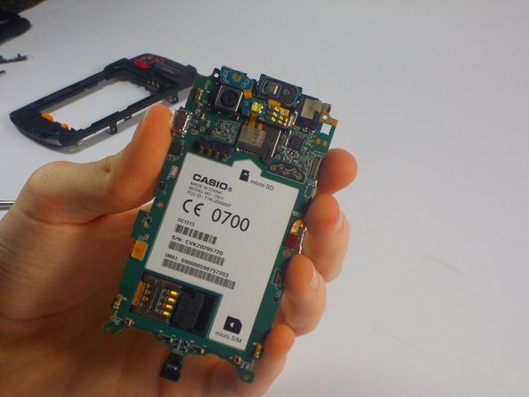

  7. Casio G’zOne Commando 4G LTE Camera Replacement: crwdns2935265:07crwdnd2935265:01crwdnd2935265:02crwdne2935265:0 Casio G’zOne Commando 4G LTE Camera Replacement: crwdns2935265:07crwdnd2935265:02crwdnd2935265:02crwdne2935265:0
    • After removing the screws carefully separate the motherboard from the shell with the spudger.

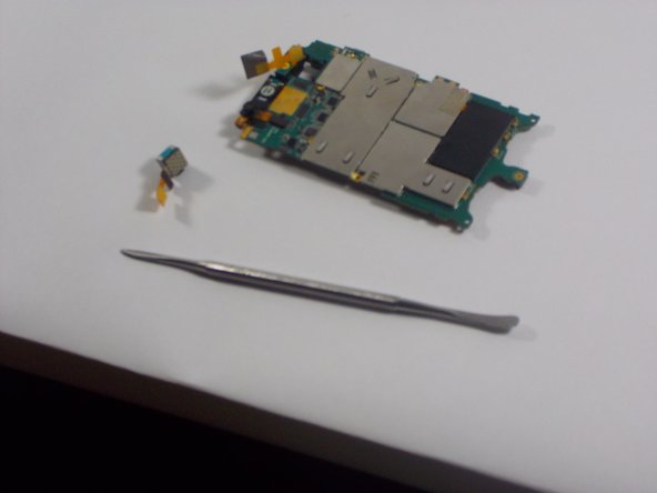

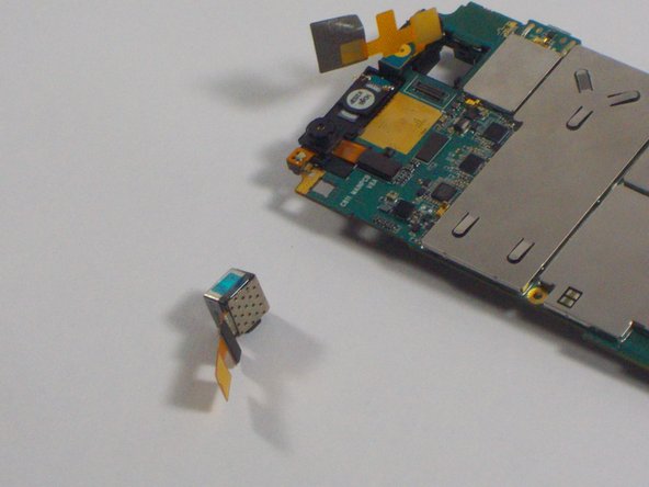

  8. Casio G’zOne Commando 4G LTE Camera Replacement, Camera: crwdns2935265:08crwdnd2935265:01crwdnd2935265:01crwdne2935265:0
    • In order to remove the camera, carefully disconnect the wires with the metal spudger.
  9. Casio G’zOne Commando 4G LTE Camera Replacement: crwdns2935265:09crwdnd2935265:01crwdnd2935265:03crwdne2935265:0 Casio G’zOne Commando 4G LTE Camera Replacement: crwdns2935265:09crwdnd2935265:02crwdnd2935265:03crwdne2935265:0 Casio G’zOne Commando 4G LTE Camera Replacement: crwdns2935265:09crwdnd2935265:03crwdnd2935265:03crwdne2935265:0
    • After disconnecting the wires, remove the camera by putting slight pressure of the optical camera lens. The camera the will pop out of the motherboard.
