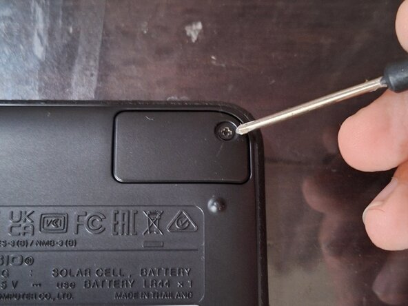

    • First, take the protective cover off the calculator.
    • Then, turn the calculator over.
    • Remove the Philips screw that holds the battery cover in place in the top-right corner.
    • Then lift the cover off by lifting the right side of the cover up, and slide it out.

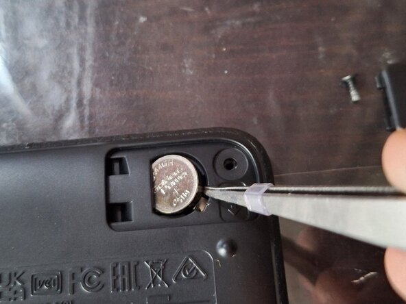

  2. Casio FX-991CW Battery Replacement, Removing the Battery: crwdns2935265:02crwdnd2935265:01crwdnd2935265:02crwdne2935265:0 Casio FX-991CW Battery Replacement, Removing the Battery: crwdns2935265:02crwdnd2935265:02crwdnd2935265:02crwdne2935265:0
    • Take a pointy, flat tool, like a flathead screwdriver, to pry the battery out of the compartment.
