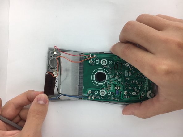

  6. Casio FX-115MS Individual Keys Replacement: crwdns2935265:06crwdnd2935265:01crwdnd2935265:02crwdne2935265:0 Casio FX-115MS Individual Keys Replacement: crwdns2935265:06crwdnd2935265:02crwdnd2935265:02crwdne2935265:0
    • Using a PH0 phillips screwdriver, unscrew the four, 4mm, pan head screws from the motherboard.

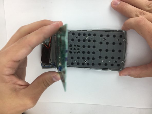

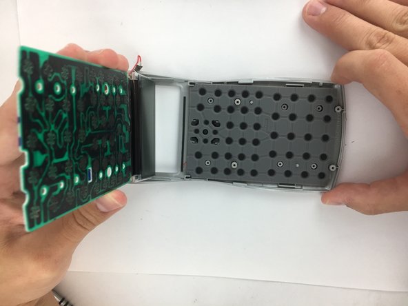

  7. Casio FX-115MS Individual Keys Replacement: crwdns2935265:07crwdnd2935265:01crwdnd2935265:03crwdne2935265:0 Casio FX-115MS Individual Keys Replacement: crwdns2935265:07crwdnd2935265:02crwdnd2935265:03crwdne2935265:0 Casio FX-115MS Individual Keys Replacement: crwdns2935265:07crwdnd2935265:03crwdnd2935265:03crwdne2935265:0
    • Carefully lift the motherboard, screen, solar panel, and battery terminal combination from the front plate. Start from the motherboard and lift at an angle toward the solar panel.

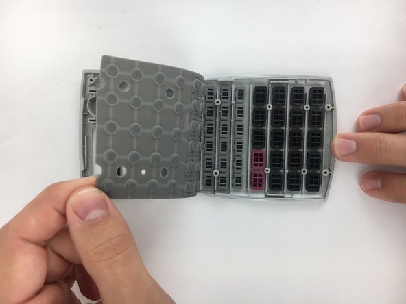

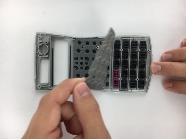

  8. Casio FX-115MS Individual Keys Replacement, Keyboard Mat: crwdns2935265:08crwdnd2935265:01crwdnd2935265:03crwdne2935265:0 Casio FX-115MS Individual Keys Replacement, Keyboard Mat: crwdns2935265:08crwdnd2935265:02crwdnd2935265:03crwdne2935265:0 Casio FX-115MS Individual Keys Replacement, Keyboard Mat: crwdns2935265:08crwdnd2935265:03crwdnd2935265:03crwdne2935265:0
    • Starting from one corner of the keyboard mat, slowly peel the mat from the front plate and individual keys.

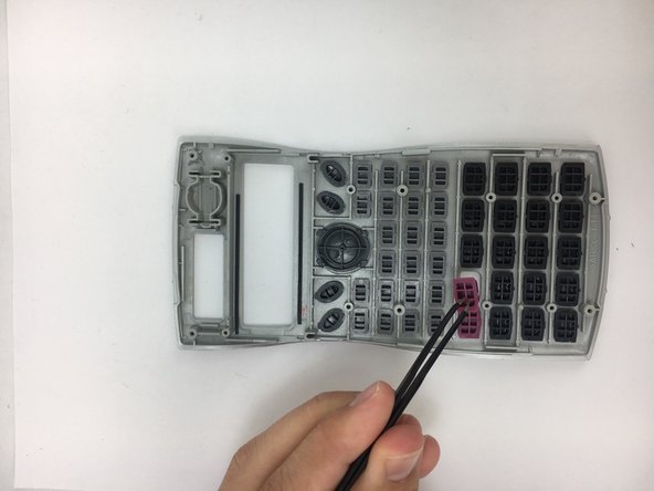

  9. Casio FX-115MS Individual Keys Replacement, Individual Keys: crwdns2935265:09crwdnd2935265:01crwdnd2935265:03crwdne2935265:0 Casio FX-115MS Individual Keys Replacement, Individual Keys: crwdns2935265:09crwdnd2935265:02crwdnd2935265:03crwdne2935265:0 Casio FX-115MS Individual Keys Replacement, Individual Keys: crwdns2935265:09crwdnd2935265:03crwdnd2935265:03crwdne2935265:0
    • Select which key you need to remove, then using the Angled ESD Tweezers pick up the key, and pull it free from the face plate.
