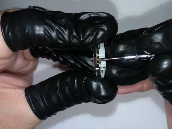

  5. Casio F-91W Battery Replacement: crwdns2935265:05crwdnd2935265:01crwdnd2935265:02crwdne2935265:0 Casio F-91W Battery Replacement: crwdns2935265:05crwdnd2935265:02crwdnd2935265:02crwdne2935265:0
    • Gently disengage the hinges holding the battery cover onto the rest of the watch movement.
    • There are four hinges to disengage—two on each side of the movement. Make sure you disengage all four before attempting to remove the battery cover to avoid damaging the movement.

Fantastic guide, thank you! On reassembling I did find I had trouble getting the watch movement back in the case. This was because the buttons were catching on the button arms. To solve it I used a flat head to push the buttons out, from the inside, as far as they would go and with a bit of persuassion it all went back in. Thanks again :-)
