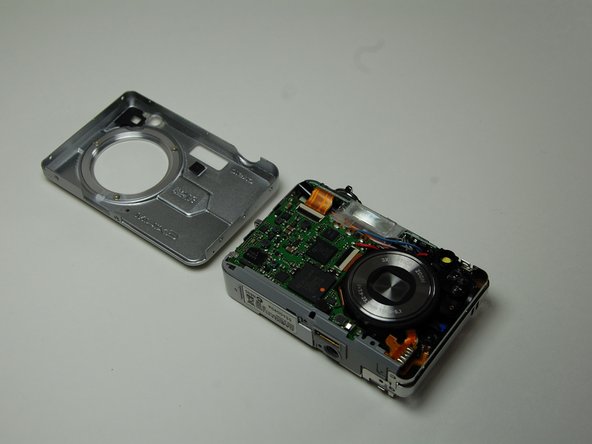

    • Once all screws have been removed, gently pry open the bottom casing.
    • With tweezers, carefully remove ribbon from LCD screen.
    • Set the bottom casing aside.

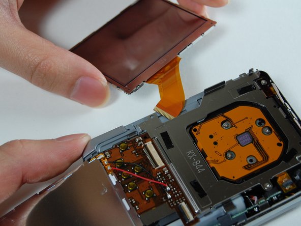

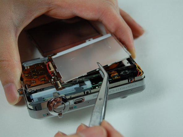

    • Use tweezers or prongs to pry the LCD screen off from the opening.
    • Note: the bottom of the LCD screen is attached to the frame by a few pieces of black tape.
  7. Casio Exilim EX-Z850 lens assembly replacement: crwdns2935265:07crwdnd2935265:01crwdnd2935265:02crwdne2935265:0 Casio Exilim EX-Z850 lens assembly replacement: crwdns2935265:07crwdnd2935265:02crwdnd2935265:02crwdne2935265:0
    • Lift up the LCD screen, and slowly move it to the other side.
  8. Casio Exilim EX-Z850 lens assembly replacement: crwdns2935265:08crwdnd2935265:01crwdnd2935265:02crwdne2935265:0 Casio Exilim EX-Z850 lens assembly replacement: crwdns2935265:08crwdnd2935265:02crwdnd2935265:02crwdne2935265:0

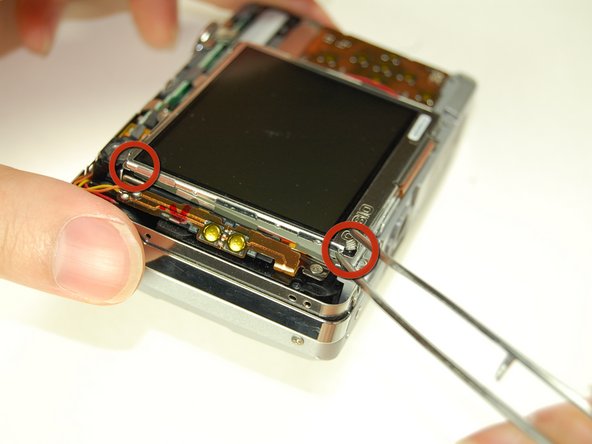

    • With tweezers, pry off the LCD casing which is taped on to the frame.
  9. Casio Exilim EX-Z850 lens assembly replacement: crwdns2935265:09crwdnd2935265:01crwdnd2935265:03crwdne2935265:0 Casio Exilim EX-Z850 lens assembly replacement: crwdns2935265:09crwdnd2935265:02crwdnd2935265:03crwdne2935265:0 Casio Exilim EX-Z850 lens assembly replacement: crwdns2935265:09crwdnd2935265:03crwdnd2935265:03crwdne2935265:0
    • With tweezers, flip open the connector holding the ribbon.
    • Pull out the LCD screen with the ribbon from the camera.

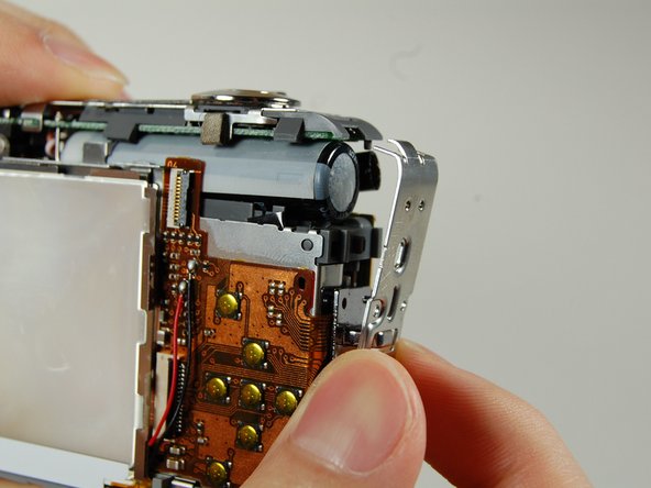

    • Remove two screws on the side where the battery is located.
    • Remove the lanyard loop after the screws come off.
    • Slowly pull the side casing so it becomes dislocated from the top of the camera frame.

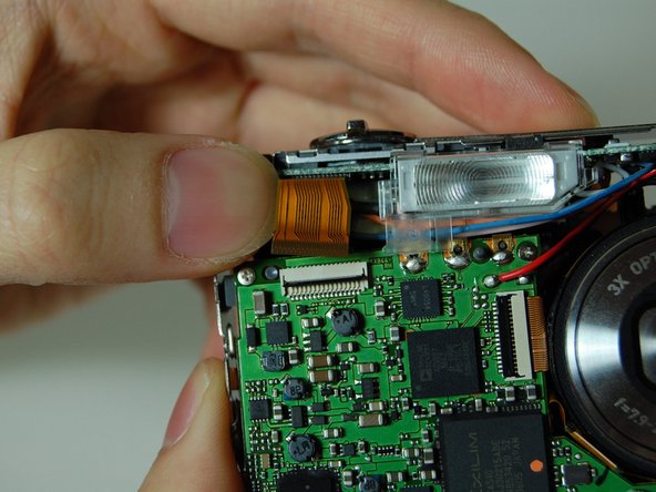

    • On the front of the camera near the flash flip the connector holding the ribbon.
    • Carefully remove the ribbon from the connector.
  13. Casio Exilim EX-Z850 lens assembly replacement: crwdns2935265:013crwdnd2935265:01crwdnd2935265:03crwdne2935265:0 Casio Exilim EX-Z850 lens assembly replacement: crwdns2935265:013crwdnd2935265:02crwdnd2935265:03crwdne2935265:0 Casio Exilim EX-Z850 lens assembly replacement: crwdns2935265:013crwdnd2935265:03crwdnd2935265:03crwdne2935265:0
    • Carefully remove the L shaped frame from the camera.
    • At the bottom of the camera the L shaped frame is being held in by two plastic bumps and a metal tab. Pop the frame off the bumps and tabs.

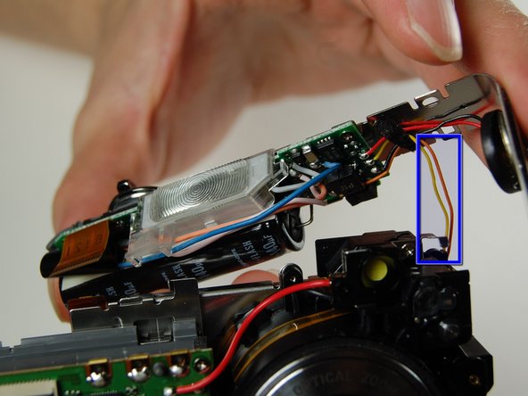

    • There is a yellow and orange wire soldered onto the camera. Be careful not to pull them off.

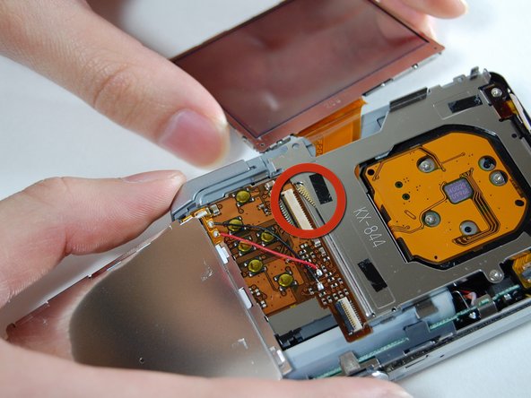

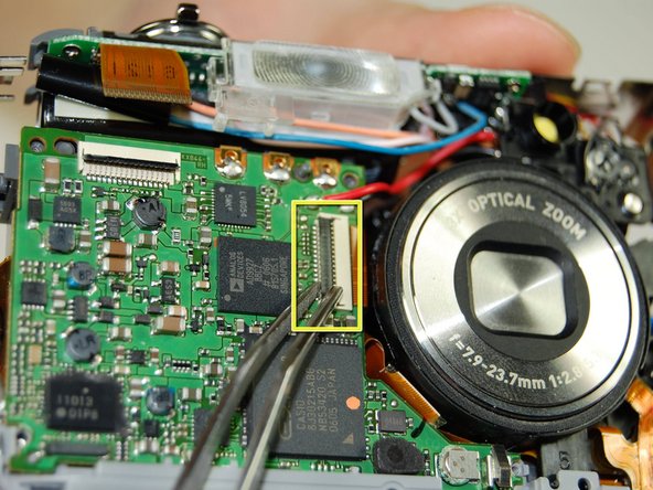

    • On the logic board next to the lens is a connector with a ribbon.
    • Flip the connector and remove the ribbon with the tweezers.

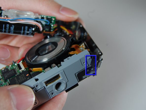

    • After removing the frame a plastic piece with two yellow button connections should fall off.
    • Note: This plastic piece is soldered to two wires a yellow and orange one.

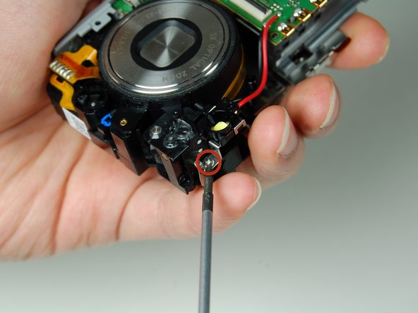

    • On the backside of the camera where the indicator lamp is located, remove the two screws with a screwdriver
  19. Casio Exilim EX-Z850 lens assembly replacement: crwdns2935265:019crwdnd2935265:01crwdnd2935265:03crwdne2935265:0 Casio Exilim EX-Z850 lens assembly replacement: crwdns2935265:019crwdnd2935265:02crwdnd2935265:03crwdne2935265:0 Casio Exilim EX-Z850 lens assembly replacement: crwdns2935265:019crwdnd2935265:03crwdnd2935265:03crwdne2935265:0
    • On the side of the indicator lamp remove a screw.
    • On the front side of the indicator lamp remove the a screw.

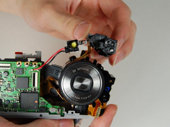

    • This should remove the indicator lamp from the lens.

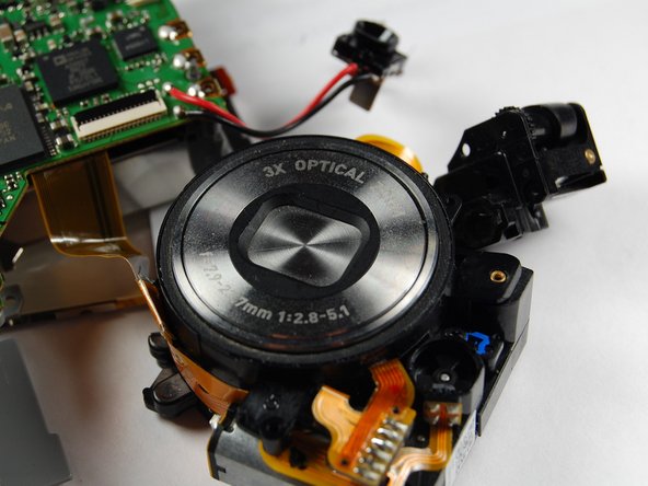

  20. Casio Exilim EX-Z850 lens assembly replacement: crwdns2935265:020crwdnd2935265:01crwdnd2935265:02crwdne2935265:0 Casio Exilim EX-Z850 lens assembly replacement: crwdns2935265:020crwdnd2935265:02crwdnd2935265:02crwdne2935265:0
    • The lens is now detached from the camera except for the ribbon soldered onto the logic board.
To put the Casio Exilim EX-Z850 camera back together, reserve the instructions to follow them in a backward manner.
