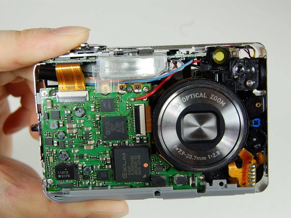

    • Remove all four screws on the camera's side using a Phillips #00 screwdriver.
    • Remove all four screws on the opposite side of the camera using the same screwdriver.
    • Remove all four screws on the bottom of the camera using the same screwdriver.
    • The bottom screws are longer than the top screws, so label them accordingly for easy reassembly.
  2. Casio Exilim EX-Z850 Outer Case Replacement: crwdns2935265:02crwdnd2935265:01crwdnd2935265:03crwdne2935265:0 Casio Exilim EX-Z850 Outer Case Replacement: crwdns2935265:02crwdnd2935265:02crwdnd2935265:03crwdne2935265:0 Casio Exilim EX-Z850 Outer Case Replacement: crwdns2935265:02crwdnd2935265:03crwdnd2935265:03crwdne2935265:0
    • Pry open the bottom casing.
    • Remove the ribbon from the LCD screen using the tweezers and set aside the bottom casing.
    • These steps should be taken carefully in order to prevent damage to the camera.
  3. Casio Exilim EX-Z850 Outer Case Replacement: crwdns2935265:03crwdnd2935265:01crwdnd2935265:02crwdne2935265:0 Casio Exilim EX-Z850 Outer Case Replacement: crwdns2935265:03crwdnd2935265:02crwdnd2935265:02crwdne2935265:0
    • Pry apart the top casing using tweezers.
    • Remove the top casing from the camera and set aside the top casing.
To reassemble your device, follow these instructions in reverse order, starting with reattaching the top casing.
