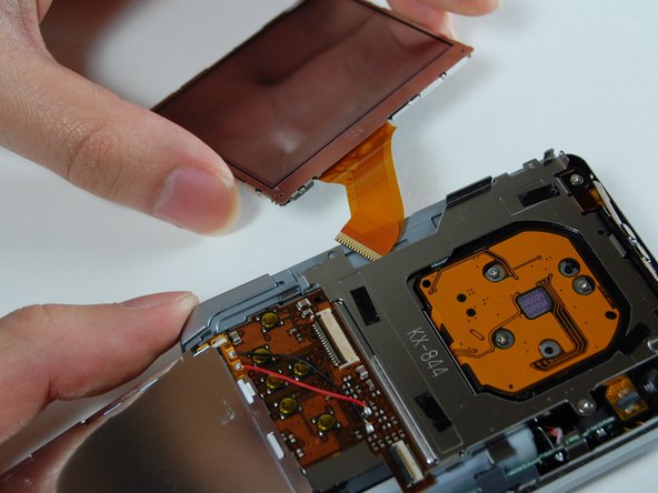

    • Use tweezers to pry the LCD screen off from the opening.
    • The bottom of the LCD screen is attached to the frame by a few pieces of black tape.

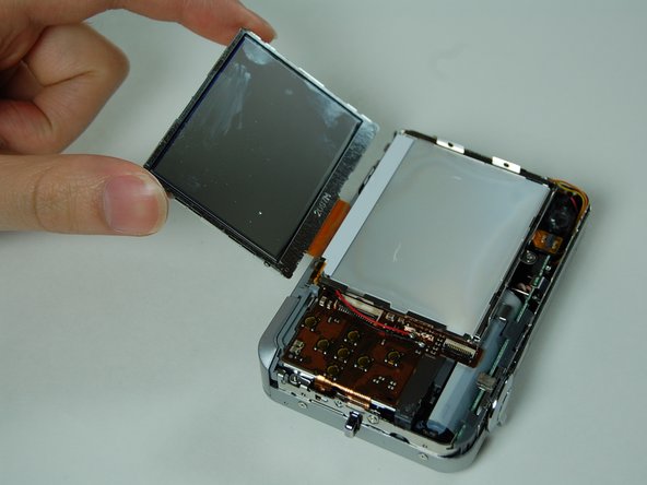

    • Use tweezers to lift up the LCD screen away from the camera.
    • Moving the screen could potentially damage the wire connecting it to the camera, so move the LCD screen slowly.

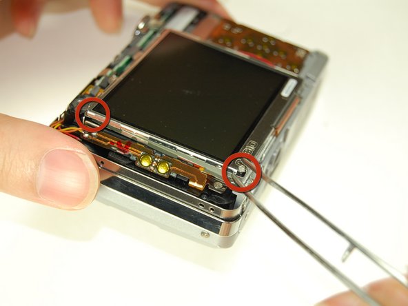

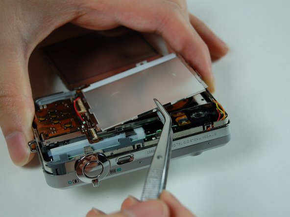

    • Use tweezers to slowly pry off LCD casing by lifting and moving it off the camera.

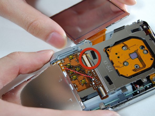

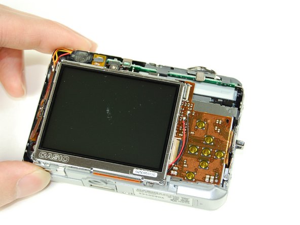

    • Use tweezers to flip open the connector holding the ribbon.
    • Gently pull out the LCD screen with the ribbon from the camera.

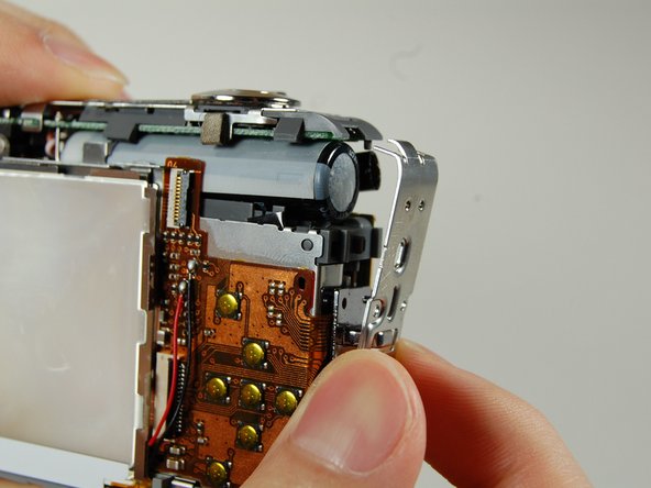

    • Using a Phillips #00 screwdriver, remove the two screws on the side where the battery is located.
    • Remove the lanyard loop after the screws come off.
    • Slowly pull the side casing so it becomes dislocated from the top of the camera frame.

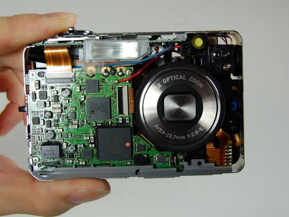

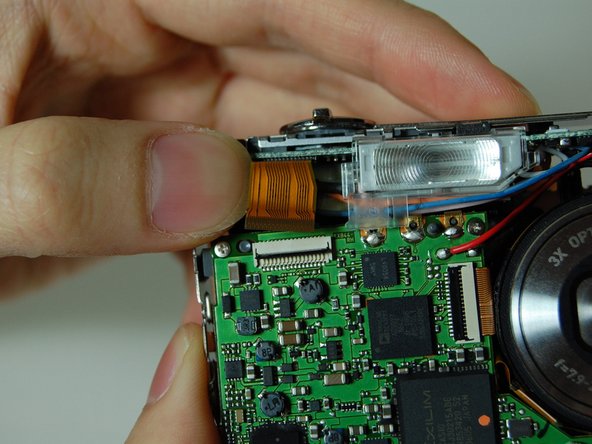

    • On the front of the camera, detach the ribbon from the connector.
  12. Casio Exilim EX-Z850 Flash Assembly Replacement: crwdns2935265:012crwdnd2935265:01crwdnd2935265:03crwdne2935265:0 Casio Exilim EX-Z850 Flash Assembly Replacement: crwdns2935265:012crwdnd2935265:02crwdnd2935265:03crwdne2935265:0 Casio Exilim EX-Z850 Flash Assembly Replacement: crwdns2935265:012crwdnd2935265:03crwdnd2935265:03crwdne2935265:0

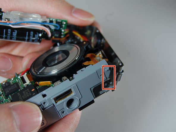

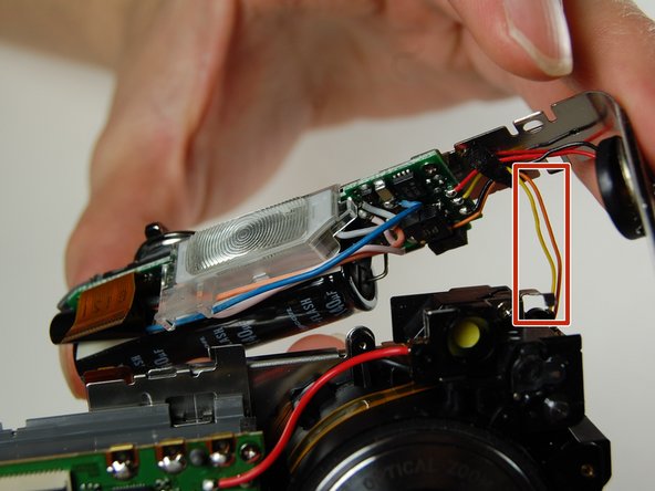

    • Carefully remove the L shaped frame from the camera.
    • There is a yellow and orange wire connected to camera. Be careful not to pull them off.
    • At the bottom of the camera, the L-shaped frame is connected by two plastic bumps and a metal tab.

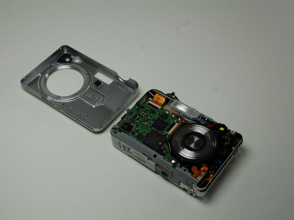

    • Using a Phillips #00 screwdriver, remove the two screws on the front of the flash assembly.
    • Remove flash assembly, and replace it with a new flash assembly.
