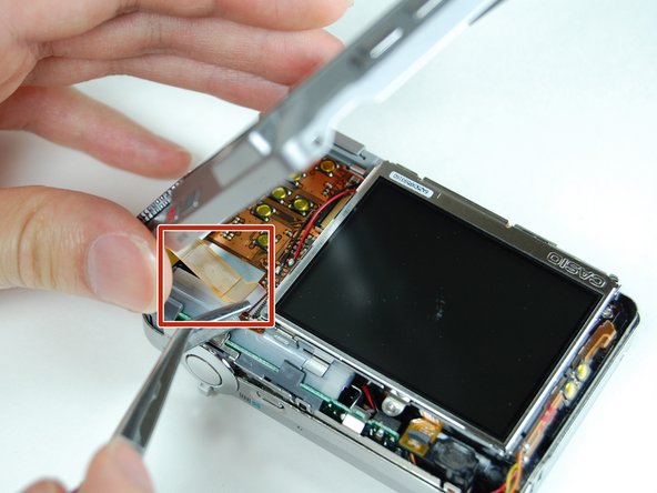

    4. Casio Exilim EX-Z850 Battery Casing Disassembly: crwdns2935265:04crwdnd2935265:01crwdnd2935265:03crwdne2935265:0 Casio Exilim EX-Z850 Battery Casing Disassembly: crwdns2935265:04crwdnd2935265:02crwdnd2935265:03crwdne2935265:0 Casio Exilim EX-Z850 Battery Casing Disassembly: crwdns2935265:04crwdnd2935265:03crwdnd2935265:03crwdne2935265:0
      • Once all screws have been removed, slowly pry open the back casing of the camera.
      • Gently remove the ribbon cable from the LCD with tweezers.
      • Set aside back casing of the camera.

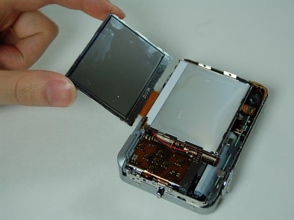

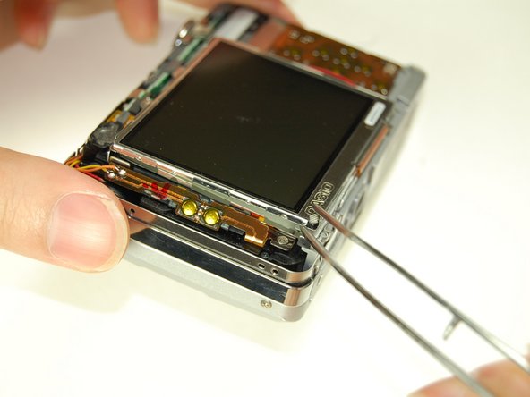

      • The bottom of the LCD screen is secured to the frame by small pieces of black tape. You will need to peel the tape away to release the LCD screen.
      • Use your tweezers to lift the LCD screen from the frame.
    7. Casio Exilim EX-Z850 Battery Casing Disassembly: crwdns2935265:07crwdnd2935265:01crwdnd2935265:02crwdne2935265:0 Casio Exilim EX-Z850 Battery Casing Disassembly: crwdns2935265:07crwdnd2935265:02crwdnd2935265:02crwdne2935265:0
      • Lift screen away from the camera with your tweezers.
      • Flip screen over gently with your fingers once it is lifted far away enough from the camera.

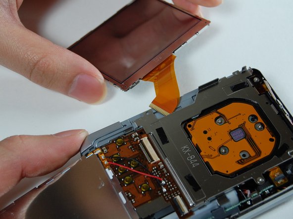

      • Use your tweezers to lift the bar holding the ribbon off.
      • Disconnect the ribbon to release the LCD screen.
      • Use your fingers to pull the LCD screen with the attached ribbon from the camera.

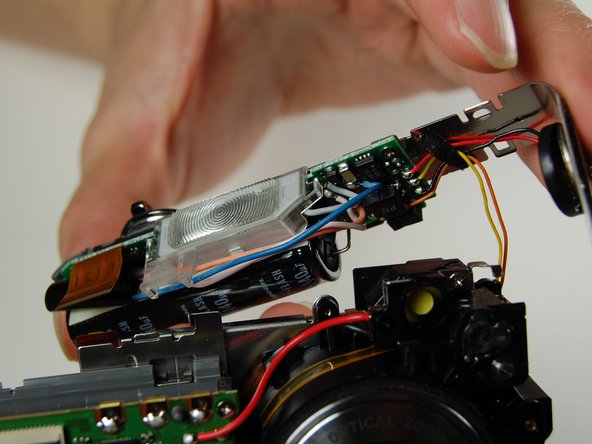

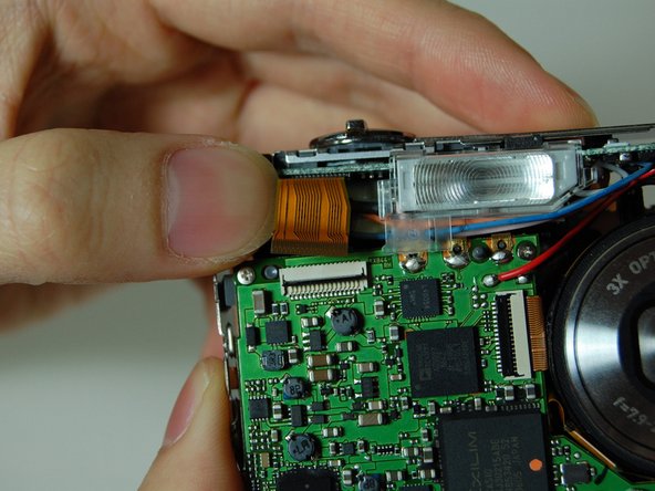

      • Hold the camera facing toward you. Pull up the bar that is securing the ribbon located to the left of the flash.
      • Disconnect the ribbon by prying it off with your fingers.
    12. Casio Exilim EX-Z850 Battery Casing Disassembly: crwdns2935265:012crwdnd2935265:01crwdnd2935265:03crwdne2935265:0 Casio Exilim EX-Z850 Battery Casing Disassembly: crwdns2935265:012crwdnd2935265:02crwdnd2935265:03crwdne2935265:0 Casio Exilim EX-Z850 Battery Casing Disassembly: crwdns2935265:012crwdnd2935265:03crwdnd2935265:03crwdne2935265:0

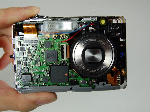

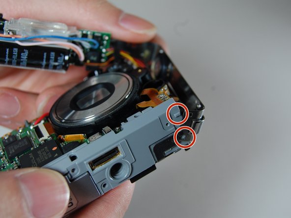

      • With the lens facing towards you, pull the L-shaped frame away from the camera.
      • Do not disconnect any of the wires from the camera when pulling the frame.
      • Remove the frame from the two studs and metal tabs keeping it in place at the bottom of the camera.

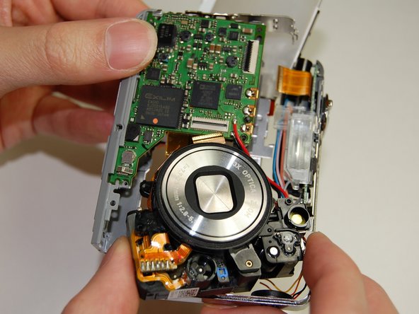

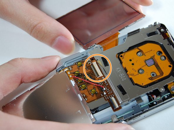

      • Locate the logic board to the left of the lens. You will see a bar securing a ribbon. Flip the bar up to release the ribbon.
      • Disconnect the ribbon.
    14. Casio Exilim EX-Z850 Battery Casing Disassembly: crwdns2935265:014crwdnd2935265:01crwdnd2935265:02crwdne2935265:0 Casio Exilim EX-Z850 Battery Casing Disassembly: crwdns2935265:014crwdnd2935265:02crwdnd2935265:02crwdne2935265:0

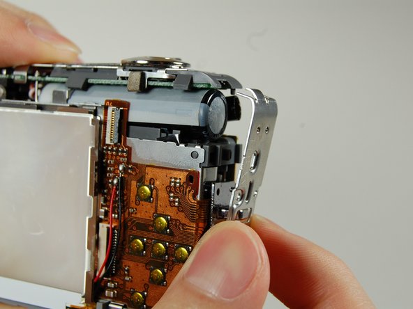

      • Use your Phillips #00 screwdriver to remove the two screws connecting the frame to the back of the camera.
      • Lift the frame away on the LCD screen side of the camera.
    15. Casio Exilim EX-Z850 Battery Casing Disassembly: crwdns2935265:015crwdnd2935265:01crwdnd2935265:02crwdne2935265:0 Casio Exilim EX-Z850 Battery Casing Disassembly: crwdns2935265:015crwdnd2935265:02crwdnd2935265:02crwdne2935265:0

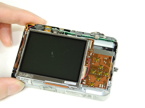

      • This is what your camera should look like now that you have the battery casing isolated.
