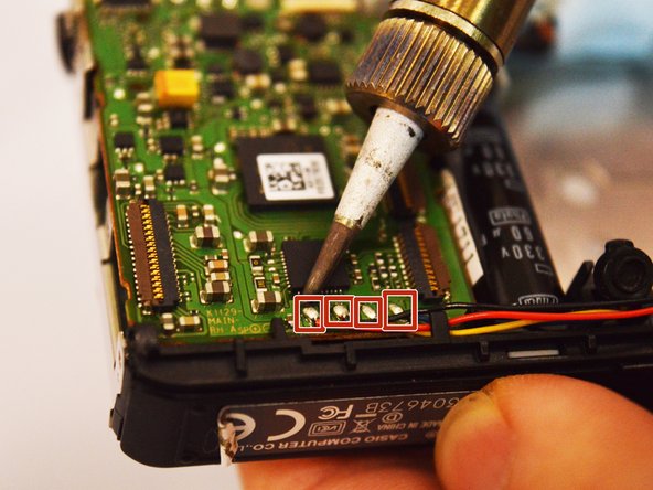

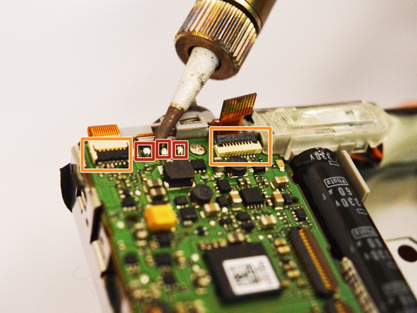

  15. Casio Exilim EX-Z80 Motherboard Replacement, Motherboard: crwdns2935265:015crwdnd2935265:01crwdnd2935265:03crwdne2935265:0 Casio Exilim EX-Z80 Motherboard Replacement, Motherboard: crwdns2935265:015crwdnd2935265:02crwdnd2935265:03crwdne2935265:0 Casio Exilim EX-Z80 Motherboard Replacement, Motherboard: crwdns2935265:015crwdnd2935265:03crwdnd2935265:03crwdne2935265:0
    • Turn the camera face up with the motherboard facing you.
    • Ensure that the soldering iron is heated and ready to use. Be careful not to touch any surfaces with hot tip.
    • At the bottom of the motherboard, there are four nodes. With the soldering iron, desolder the metal nodes to release the wires from the board.
    • With the soldering iron, desolder the three remaining nodes at the top of the motherboard.
    • Lift the two black retaining flaps on the ZIF connectors at the top of the motherboard.

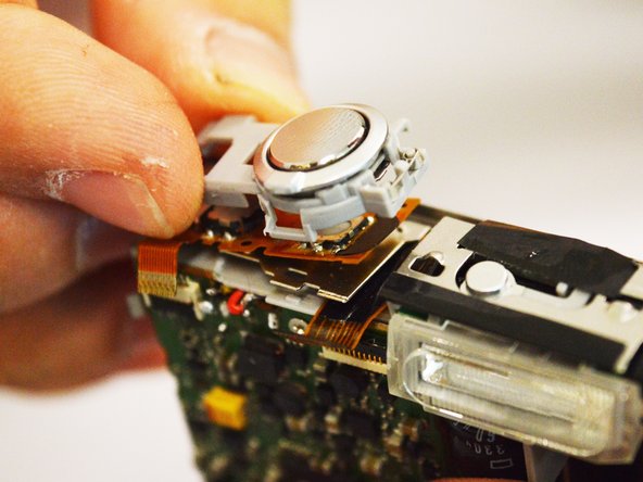

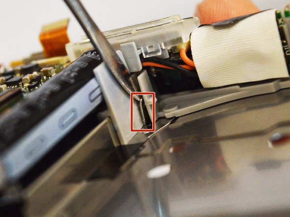

  16. Casio Exilim EX-Z80 Motherboard Replacement: crwdns2935265:016crwdnd2935265:01crwdnd2935265:03crwdne2935265:0 Casio Exilim EX-Z80 Motherboard Replacement: crwdns2935265:016crwdnd2935265:02crwdnd2935265:03crwdne2935265:0 Casio Exilim EX-Z80 Motherboard Replacement: crwdns2935265:016crwdnd2935265:03crwdnd2935265:03crwdne2935265:0
    • Gently pull the black plastic case from the bottom of the camera.
    • Pull out the little white plastic (the power button) on the top of the camera. It may be covered by a piece of black tape. Pulling the tape will allow for the power button to be released.

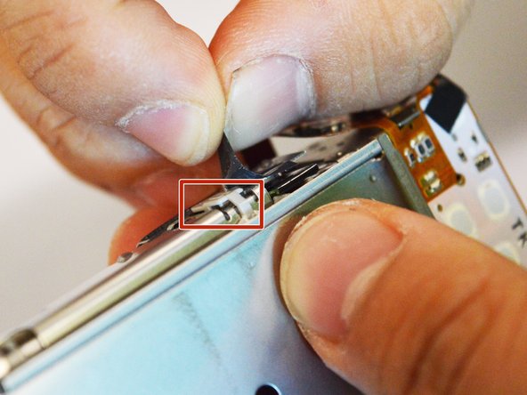

  17. Casio Exilim EX-Z80 Motherboard Replacement: crwdns2935265:017crwdnd2935265:01crwdnd2935265:02crwdne2935265:0 Casio Exilim EX-Z80 Motherboard Replacement: crwdns2935265:017crwdnd2935265:02crwdnd2935265:02crwdne2935265:0
    • Insert a metal spudger into the edge of the camera shutter button and pry the button out.
    • Remove the button by pinching and pulling with two fingers.
  18. Casio Exilim EX-Z80 Motherboard Replacement: crwdns2935265:018crwdnd2935265:01crwdnd2935265:03crwdne2935265:0 Casio Exilim EX-Z80 Motherboard Replacement: crwdns2935265:018crwdnd2935265:02crwdnd2935265:03crwdne2935265:0 Casio Exilim EX-Z80 Motherboard Replacement: crwdns2935265:018crwdnd2935265:03crwdnd2935265:03crwdne2935265:0

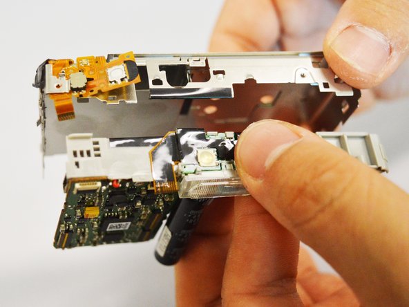

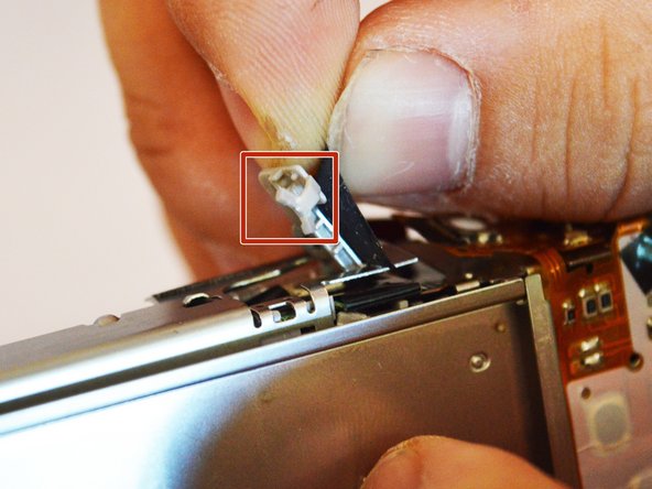

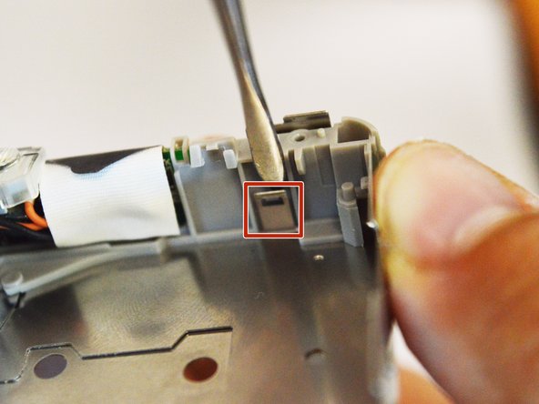

    • Pry the iron tabs with the metal spudger in order to free the motherboard. There are three places to pry. Once you are done, the mother board should be able to move.
  19. Casio Exilim EX-Z80 Motherboard Replacement: crwdns2935265:019crwdnd2935265:01crwdnd2935265:02crwdne2935265:0 Casio Exilim EX-Z80 Motherboard Replacement: crwdns2935265:019crwdnd2935265:02crwdnd2935265:02crwdne2935265:0
    • Gently push the motherboard up from the bottom of the camera. Then pull the motherboard out at the top of the camera.
    • Use gentle force to pry out the motherboard.
