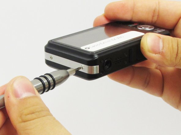

      • Open the USB port tab.
      • Remove the single 2 mm silver screw using a Phillips #000 screwdriver.
    3. Casio Exilim EX-Z80 Lens Replacement: crwdns2935265:03crwdnd2935265:01crwdnd2935265:02crwdne2935265:0 Casio Exilim EX-Z80 Lens Replacement: crwdns2935265:03crwdnd2935265:02crwdnd2935265:02crwdne2935265:0
      • Remove the two 2 mm silver screws using a Phillips #000 screwdriver.

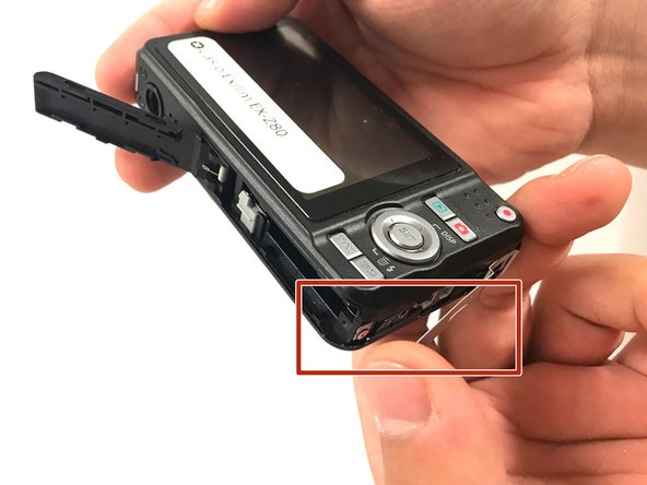

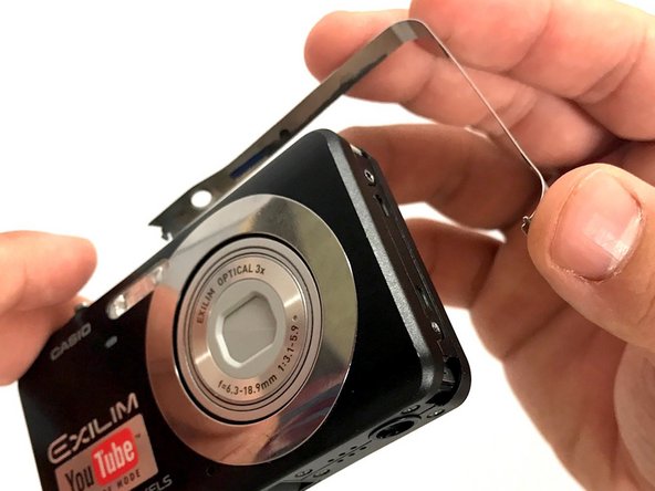

      • Carefully remove the silver strip from left side. Open the battery cover and remove the metal strip with fingers by sliding it to the left.
    5. Casio Exilim EX-Z80 Lens Replacement: crwdns2935265:05crwdnd2935265:01crwdnd2935265:02crwdne2935265:0 Casio Exilim EX-Z80 Lens Replacement: crwdns2935265:05crwdnd2935265:02crwdnd2935265:02crwdne2935265:0

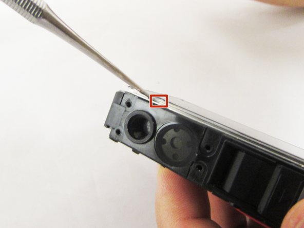

      • With the metal spudger, pry out the edge of the silver strip at the bottom right side of the camera.
      • Carefully remove the remaining part of the metal strip.

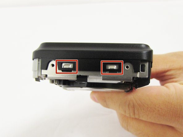

    7. Casio Exilim EX-Z80 Lens Replacement: crwdns2935265:07crwdnd2935265:01crwdnd2935265:03crwdne2935265:0 Casio Exilim EX-Z80 Lens Replacement: crwdns2935265:07crwdnd2935265:02crwdnd2935265:03crwdne2935265:0 Casio Exilim EX-Z80 Lens Replacement: crwdns2935265:07crwdnd2935265:03crwdnd2935265:03crwdne2935265:0

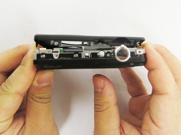

      • Using a small opening tool carefully release all lock tabs at the top and on the side of the camera from their locked position.
      • Using your hands, carefully separate the front and back panel from the camera.

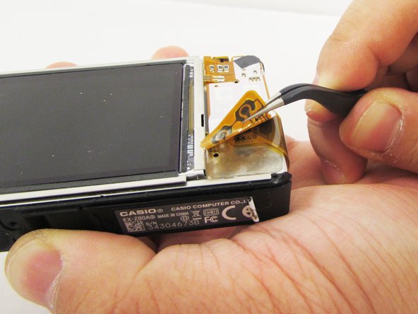

      • Gently flip the wide button cable up from the display cable.
      • Lift the brown retention flap on the display cable ZIF connector with tweezers or an ESD-safe tool.
      • Carefully pull the display cable from its connector.

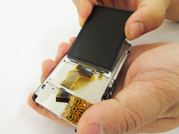

      • Pry the square holes that hold the LCD screen up with a metal spudger until you see the raised tabs in the metal holes.
      • Repeat the process with the holes around the four edges of the camera.
      • Insert the metal spudger into the gap of the metal case and pry up the LCD screen.
    3. Casio Exilim EX-Z80 Lens Replacement: crwdns2935265:010crwdnd2935265:01crwdnd2935265:03crwdne2935265:0 Casio Exilim EX-Z80 Lens Replacement: crwdns2935265:010crwdnd2935265:02crwdnd2935265:03crwdne2935265:0 Casio Exilim EX-Z80 Lens Replacement: crwdns2935265:010crwdnd2935265:03crwdnd2935265:03crwdne2935265:0

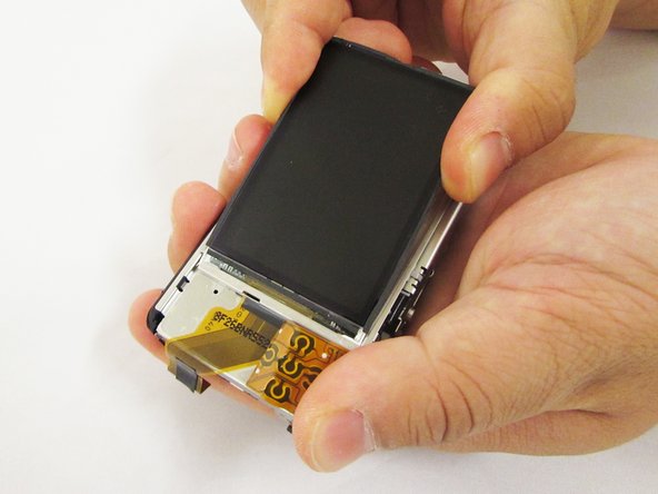

      • Hold up the LCD screen in one hand and hold back the button cable with the other.
      • Don't let the LCD screen to fall back into the metal case and make sure the button cable does not get stuck on the display cable.
      • Pull on the LCD screen until the yellow display cable is fully out of the metal case.

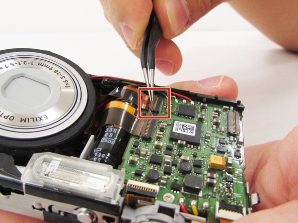

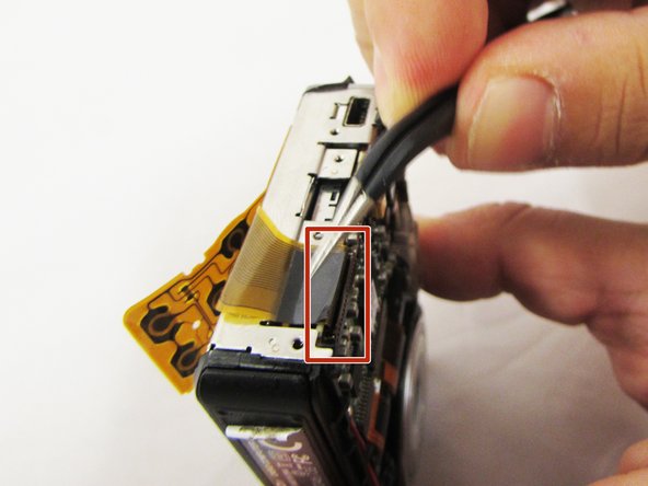

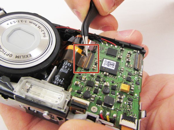

      • Lift the retaining flaps on the two ZIF connectors that secure the the lens ribbon cables to the motherboard.
      • Carefully pull the two ribbon cables from their sockets on the motherboard.

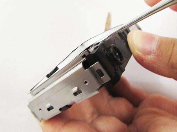

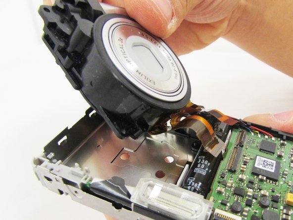

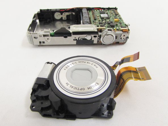

      • Turn the camera around and locate the holes on the metal panel.
      • With a heavy duty spudger, gently poke through the holes, releasing the lens from the main portion of the camera.
      • With your index finger and thumb gently pull the full lens out.
