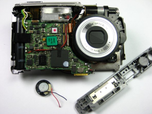

    • Look at the bottom of the camera. Take out the Phillips screw (1.77 mm) holding on the bottom plastic piece.
    • The bottom plastic piece is held on to the main frame of the camera only by two thin wires.

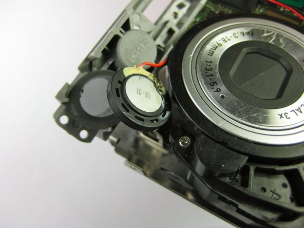

    • The speaker is attached to the bottom of the camera casing with tape.
    • Use a spudger to gently peel the speaker away from the camera casing.

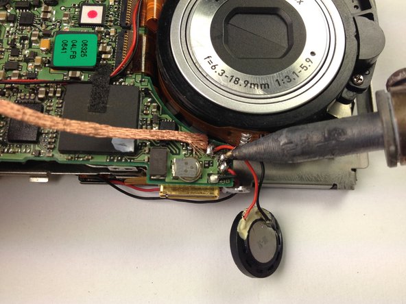

    • Using a soldering station and a solder wick or other solder removal tool, carefully remove the solder holding the two wires of the speaker to the circuit board.
    • There are two other soldering joints right next to the soldering joints for the speaker. These soldering joints are for the LCD screen only and should not be removed. Remove only the solder holding the speaker to the circuit board.
