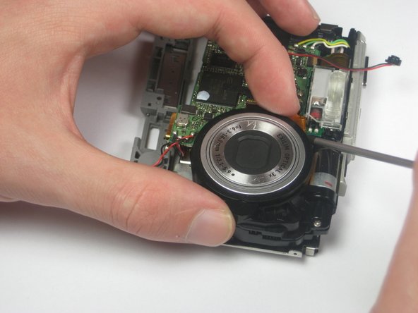

    • The lens is held in place by two metal tabs: one located directly under the circuit board between the flash and the lens and the other located between the lens and the speaker.
    • Using a screwdriver, push the metal tab toward the center of the circuit board.
    • This frees the lens in that corner. However, this step may take some tweaking to properly release the lens.
  11. Casio Exilim EX-Z70 Lens Replacement: crwdns2935265:011crwdnd2935265:01crwdnd2935265:02crwdne2935265:0 Casio Exilim EX-Z70 Lens Replacement: crwdns2935265:011crwdnd2935265:02crwdnd2935265:02crwdne2935265:0
    • As you pull the lens up and out of the casing, push the hook in the lower right hand corner of the lens out of the way.
    • At this point the lens should be connected to the camera solely by two orange plastic strips.

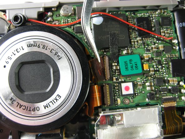

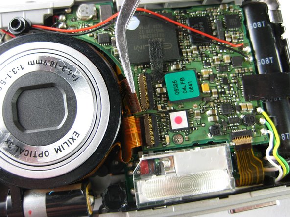

  12. Casio Exilim EX-Z70 Lens Replacement: crwdns2935265:012crwdnd2935265:01crwdnd2935265:03crwdne2935265:0 Casio Exilim EX-Z70 Lens Replacement: crwdns2935265:012crwdnd2935265:02crwdnd2935265:03crwdne2935265:0 Casio Exilim EX-Z70 Lens Replacement: crwdns2935265:012crwdnd2935265:03crwdnd2935265:03crwdne2935265:0
    • Using tweezers or your finger nails, pull up the brown flaps where the two orange film strips connected to the lens meet the circuit board.
    • Use the tweezers to pull the orange film strips out of the port. It should come out easily.
    • There are two additional film strips connected to the circuit board that do not need to be removed. These are connected to the side of the circuit board that is opposite to the lens

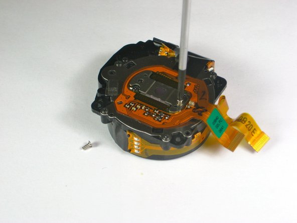

    • Turn the lens over
    • On the back are four screws. Remove the two silver phillips screws (4.36 mm) from the back of the lens.
  15. Casio Exilim EX-Z70 Lens Replacement: crwdns2935265:015crwdnd2935265:01crwdnd2935265:01crwdne2935265:0
    • Remove the now loose orange piece from the back of the lens and set it aside.
    • The lens is now ready to cleaned and maintained or replaced with a new one.
    • Since a new lens does not come with the orange film or electronic image sensor, make sure that you keep both the 4 screws and the image sensor and replace them when you install the new lens.
