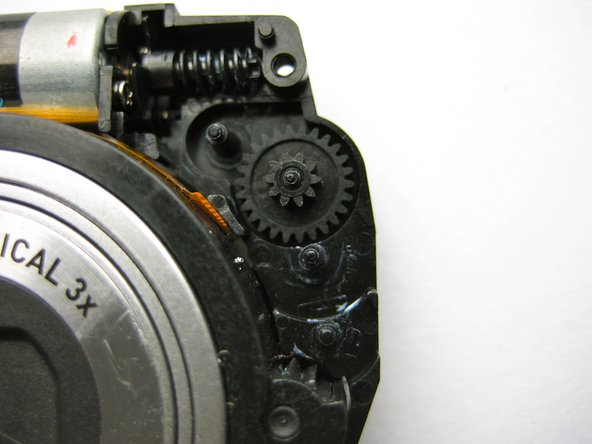

  16. Casio Exilim EX-Z70 Lens Gear Cleaning "Lens Error" Replacement, Lens Gear Cleaning "Lens Error": crwdns2935265:016crwdnd2935265:01crwdnd2935265:02crwdne2935265:0 Casio Exilim EX-Z70 Lens Gear Cleaning "Lens Error" Replacement, Lens Gear Cleaning "Lens Error": crwdns2935265:016crwdnd2935265:02crwdnd2935265:02crwdne2935265:0
    • Now that the lens is fully exposed, remove the two phillips screws (4.34 mm) on front of the lens.
  17. Casio Exilim EX-Z70 Lens Gear Cleaning "Lens Error" Replacement: crwdns2935265:017crwdnd2935265:01crwdnd2935265:03crwdne2935265:0 Casio Exilim EX-Z70 Lens Gear Cleaning "Lens Error" Replacement: crwdns2935265:017crwdnd2935265:02crwdnd2935265:03crwdne2935265:0 Casio Exilim EX-Z70 Lens Gear Cleaning "Lens Error" Replacement: crwdns2935265:017crwdnd2935265:03crwdnd2935265:03crwdne2935265:0
    • Using a pair of tweezers, carefully remove the four gears. They will already be loose on their axles.
    • Since the gears will have to be put back into their casing when replacing the lens, it may be helpful to write down where each gear goes. The pictures for this step can also be used as a reference.
  18. Casio Exilim EX-Z70 Lens Gear Cleaning "Lens Error" Replacement: crwdns2935265:018crwdnd2935265:01crwdnd2935265:01crwdne2935265:0
    • Clean the gear box and the gears with water and a cloth or paper towel. A pin can be useful to dislodge any grit or dirt stuck in between the teeth of the gears.
