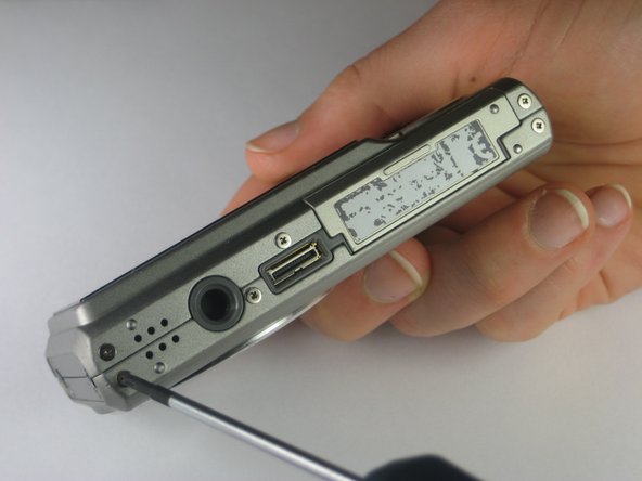

    • Remove the six Phillips screws (3.69 mm) from the bottom of the camera casing.

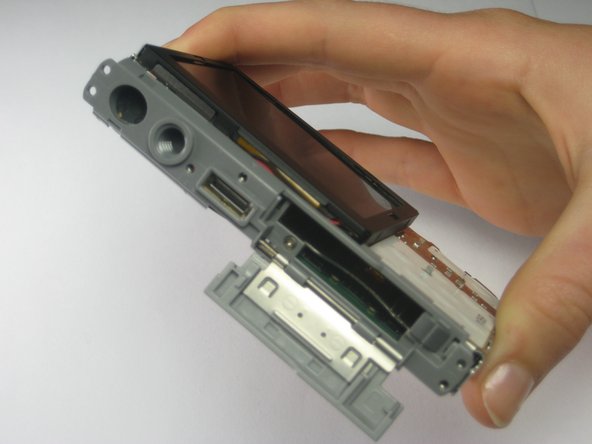

  8. Casio Exilim EX-Z70 LCD Screen Replacement: crwdns2935265:08crwdnd2935265:01crwdnd2935265:02crwdne2935265:0 Casio Exilim EX-Z70 LCD Screen Replacement: crwdns2935265:08crwdnd2935265:02crwdnd2935265:02crwdne2935265:0

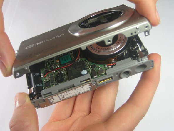

    • Look at the bottom of the camera. Take out the Phillips screw (1.77 mm) holding on the bottom plastic piece.
    • The bottom plastic piece is held on to the main frame of the camera only by two thin wires.

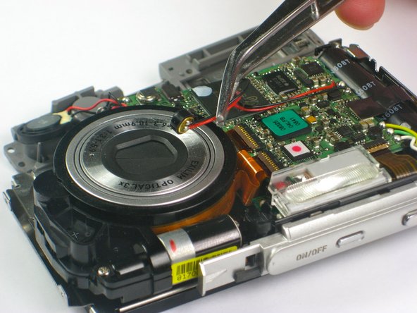

    • Orient the camera with the lens facing up and the flash towards you for the clearest visibility.
    • Using a pair of tweezers, gently move the red and black wires away from the lens.

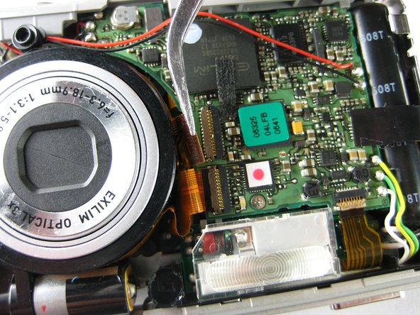

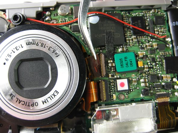

    • Using tweezers or your finger nails, pull up the brown flaps where the three orange film strips meet the circuit board.
    • Use the tweezers to pull all three orange film strips out of each port. The strips should come out easily.

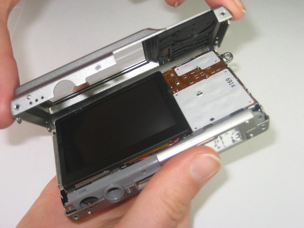

  11. Casio Exilim EX-Z70 LCD Screen Replacement: crwdns2935265:011crwdnd2935265:01crwdnd2935265:03crwdne2935265:0 Casio Exilim EX-Z70 LCD Screen Replacement: crwdns2935265:011crwdnd2935265:02crwdnd2935265:03crwdne2935265:0 Casio Exilim EX-Z70 LCD Screen Replacement: crwdns2935265:011crwdnd2935265:03crwdnd2935265:03crwdne2935265:0

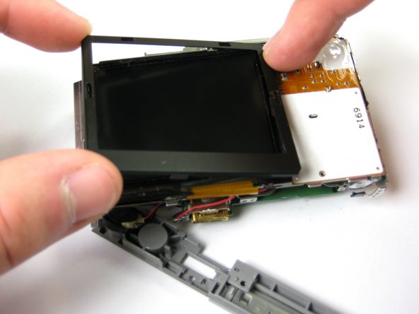

    • Flip the camera over to the side with the LCD screen.
    • Gently remove the plastic cover that borders the LCD screen starting with the top left corner, then the bottom left corner, and finally the bottom and top right corners.
    • The LCD screen is now loose from the camera; it should only be connected by a gold strip that attaches to the circuit board.

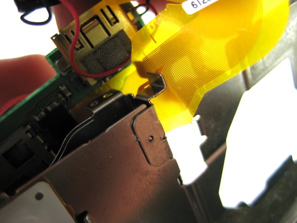

  13. Casio Exilim EX-Z70 LCD Screen Replacement: crwdns2935265:013crwdnd2935265:01crwdnd2935265:03crwdne2935265:0 Casio Exilim EX-Z70 LCD Screen Replacement: crwdns2935265:013crwdnd2935265:02crwdnd2935265:03crwdne2935265:0 Casio Exilim EX-Z70 LCD Screen Replacement: crwdns2935265:013crwdnd2935265:03crwdnd2935265:03crwdne2935265:0

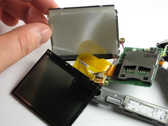

    • At this point, the LCD screen and the circuit board are only attached to the camera by a thin gold strip on the far left of the circuit board.
    • Slide the gold strip that connects the LCD screen to the circuit board through the small gap at the bottom of the camera.

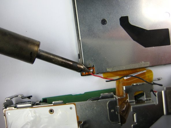

  14. Casio Exilim EX-Z70 LCD Screen Replacement: crwdns2935265:014crwdnd2935265:01crwdnd2935265:02crwdne2935265:0 Casio Exilim EX-Z70 LCD Screen Replacement: crwdns2935265:014crwdnd2935265:02crwdnd2935265:02crwdne2935265:0
    • Using a soldering station and solder wick or other solder removing instrument, remove the solder holding the two wires of the LCD screen to the circuit board.
    • You have now completely removed your LCD screen. It can now be replaced or cleaned.
