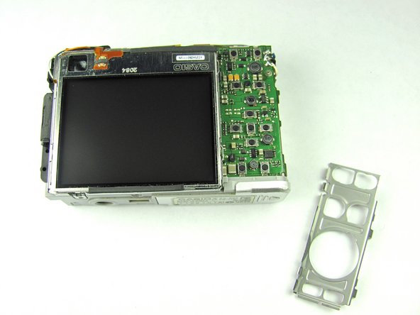

    1. Casio Exilim EX Z55 Lens Replacement, LCD Screen: crwdns2935265:05crwdnd2935265:01crwdnd2935265:03crwdne2935265:0 Casio Exilim EX Z55 Lens Replacement, LCD Screen: crwdns2935265:05crwdnd2935265:02crwdnd2935265:03crwdne2935265:0 Casio Exilim EX Z55 Lens Replacement, LCD Screen: crwdns2935265:05crwdnd2935265:03crwdnd2935265:03crwdne2935265:0
      • Remove the metal grating located to the right of the LCD screen by inserting the plastic opening tool under the grating and pulling up.
    2. Casio Exilim EX Z55 Lens Replacement: crwdns2935265:06crwdnd2935265:01crwdnd2935265:01crwdne2935265:0

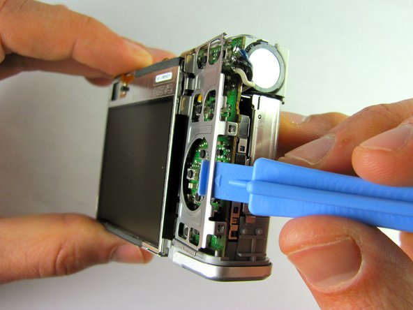

      • Before removing the side metal bracket, first remove the attached strap knob by twisting it off.
      • Then, remove the side metal bracket by inserting the plastic opening tool under the bracket and pulling up.
    3. Casio Exilim EX Z55 Lens Replacement: crwdns2935265:07crwdnd2935265:01crwdnd2935265:01crwdne2935265:0
      • Using the plastic opening tool, pry up the LCD screen starting at one of the corners. Insert the tool under one of the corners and lift up.

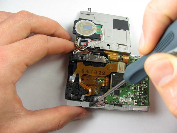

      • Remove the two 1.66mm screws on both the bottom and top metal plates, using a #00 Phillips screwdriver.
    3. Casio Exilim EX Z55 Lens Replacement: crwdns2935265:011crwdnd2935265:01crwdnd2935265:01crwdne2935265:0
      • Using the plastic opening tool, pry the battery case clamps (located on front of the camera) so that the bottom portion of the camera will come loose.
    4. Casio Exilim EX Z55 Lens Replacement: crwdns2935265:012crwdnd2935265:01crwdnd2935265:01crwdne2935265:0

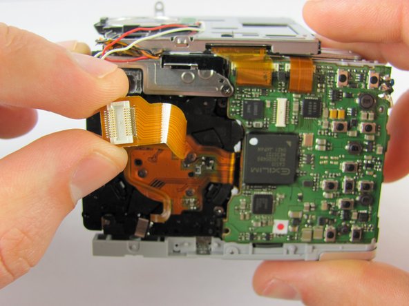

      • Once the bottom portion of the camera is removed, stand the camera upright, bottom portion facing up, then detach the inner orange strip from the motherboard to the lens by inserting the plastic opening tool under the tab and lifting up.

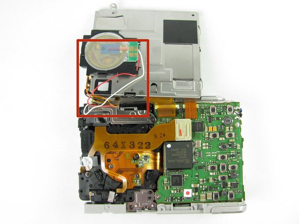

    5. Casio Exilim EX Z55 Lens Replacement: crwdns2935265:013crwdnd2935265:01crwdnd2935265:01crwdne2935265:0
      • Fully remove the lens from the motherboard.
      • It will still be attached by wires and a different orange ribbon cable.
      • You can now proceed to repair the existing lens or replace it with a new lens.
