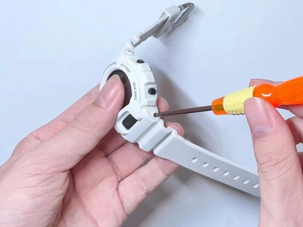

    • There are four screws— two on each side of the watch case.
    • Use the Philllips screwdriver to remove four 4.5 mm screws.

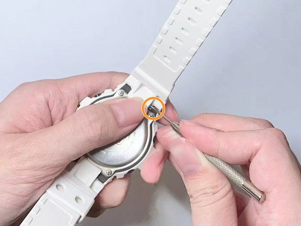

    • There are two trunnions on both sides of the watch, and there are four grooves.
    • Use a small flat-blade screwdriver and push inward to remove the trunnion. And remove the strap.
