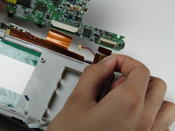

  15. Casio Cassiopeia E-125 Motherboard Replacement: crwdns2935265:015crwdnd2935265:01crwdnd2935265:01crwdne2935265:0
    • Remove the the three screws on the motherboard that are shown using the Phillips #00 Screwdriver.
  16. Casio Cassiopeia E-125 Motherboard Replacement: crwdns2935265:016crwdnd2935265:01crwdnd2935265:01crwdne2935265:0
    • Caution: do not break ribbon cables from the motherboard because this may cause damage to your device.
    • Flip the motherboard towards the front cover to expose the ribbon cables underneath.
  17. Casio Cassiopeia E-125 Motherboard Replacement: crwdns2935265:017crwdnd2935265:01crwdnd2935265:02crwdne2935265:0 Casio Cassiopeia E-125 Motherboard Replacement: crwdns2935265:017crwdnd2935265:02crwdnd2935265:02crwdne2935265:0
    • Locate the two ribbon cables on the motherboard. Select one to remove first and then pinch either side of it and pull out to remove the ribbon cable. Do the same for the second.
