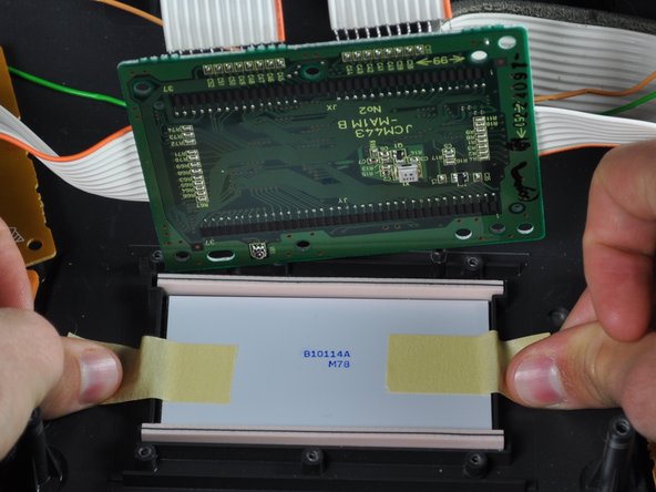

    1. Casio CTK-501 LCD Screen Replacement, LCD Screen: crwdns2935265:04crwdnd2935265:01crwdnd2935265:01crwdne2935265:0
      • Completely unscrew and remove all six of the screws on the central circuit board.
    2. Casio CTK-501 LCD Screen Replacement: crwdns2935265:05crwdnd2935265:01crwdnd2935265:01crwdne2935265:0
      • Lift the circuit board out of your way.
    3. Casio CTK-501 LCD Screen Replacement: crwdns2935265:06crwdnd2935265:01crwdnd2935265:01crwdne2935265:0
      • Remove tape from the LCD screen and remove the screen completely.
    4. Casio CTK-501 LCD Screen Replacement: crwdns2935265:07crwdnd2935265:01crwdnd2935265:02crwdne2935265:0 Casio CTK-501 LCD Screen Replacement: crwdns2935265:07crwdnd2935265:02crwdnd2935265:02crwdne2935265:0
      • Replace the LCD screen and tape it down to the top cover.
    5. Casio CTK-501 LCD Screen Replacement: crwdns2935265:08crwdnd2935265:01crwdnd2935265:01crwdne2935265:0
      • Place the circuit board back on top of the LCD screen.
      • Screw all of the screws completely in their original positions.
