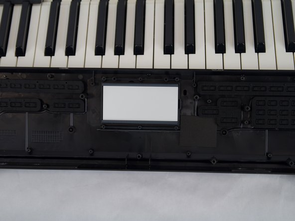

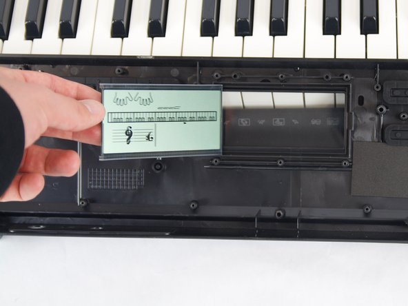

  7. Casio CTK-3200 LCD Screen Replacement, LCD Screen: crwdns2935265:07crwdnd2935265:01crwdnd2935265:02crwdne2935265:0 Casio CTK-3200 LCD Screen Replacement, LCD Screen: crwdns2935265:07crwdnd2935265:02crwdnd2935265:02crwdne2935265:0
    • Carefully lift out the LCD screen.
    • If the screen has not been taken off before it might seem like it is glued to the board; this is normal.
  8. Casio CTK-3200 LCD Screen Replacement: crwdns2935265:08crwdnd2935265:01crwdnd2935265:02crwdne2935265:0 Casio CTK-3200 LCD Screen Replacement: crwdns2935265:08crwdnd2935265:02crwdnd2935265:02crwdne2935265:0
    • Place your new screen face down into the center panel. Lay the screen exactly as shown in the first image, then let it fall over and land face down into place.
    • Make sure the screen is right side up. This will ensure that all of the electrical components line up correctly when the main board is re-attached to the center panel.
