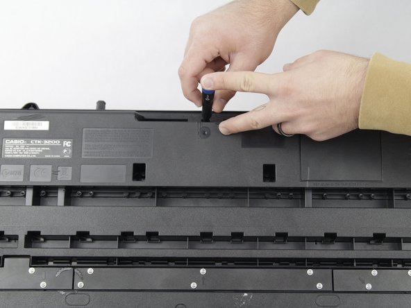

  1. Casio CTK-3200 Key Replacement, Center Front Panel: crwdns2935265:01crwdnd2935265:01crwdnd2935265:02crwdne2935265:0 Casio CTK-3200 Key Replacement, Center Front Panel: crwdns2935265:01crwdnd2935265:02crwdnd2935265:02crwdne2935265:0
    • Remove the seven 10 mm Phillips #1 screws on the underside of the keyboard that secure the center front panel.

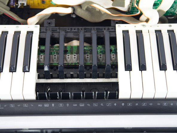

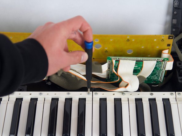

  5. Casio CTK-3200 Key Replacement, Key: crwdns2935265:05crwdnd2935265:01crwdnd2935265:02crwdne2935265:0 Casio CTK-3200 Key Replacement, Key: crwdns2935265:05crwdnd2935265:02crwdnd2935265:02crwdne2935265:0
    • Target which key(s) need to be replaced and unscrew the 10 mm Phillips #1 screws for the targeted section(s).
    • There are five different sections of white keys, you can tell the sections apart by the small gaps between them where the screws are attached.

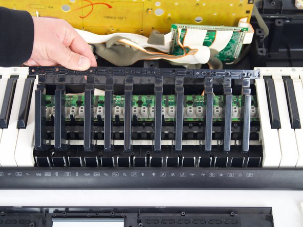

  6. Casio CTK-3200 Key Replacement: crwdns2935265:06crwdnd2935265:01crwdnd2935265:03crwdne2935265:0 Casio CTK-3200 Key Replacement: crwdns2935265:06crwdnd2935265:02crwdnd2935265:03crwdne2935265:0 Casio CTK-3200 Key Replacement: crwdns2935265:06crwdnd2935265:03crwdnd2935265:03crwdne2935265:0
    • If the broken key(s) are white, remove the set of white keys with the broken piece.
    • If the broken key(s) are black, remove two sets of seven white keys. This will reveal the set of black keys, which are twice the length of the white sets.
    • The key sets can be troublesome to remove. To remove without further damage, make sure to lift up on the top part as shown and push the bottom part of the keys towards the bottom of the keyboard to unhook them individually.
