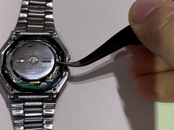

    • Remove the back cover and the black rubber band with tweezers.
  3. Casio A158WA-1 Watch Circuit Board Replacement: crwdns2935265:03crwdnd2935265:01crwdnd2935265:02crwdne2935265:0 Casio A158WA-1 Watch Circuit Board Replacement: crwdns2935265:03crwdnd2935265:02crwdnd2935265:02crwdne2935265:0

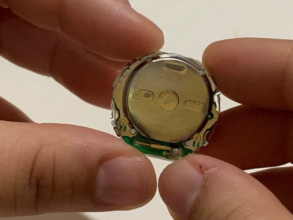

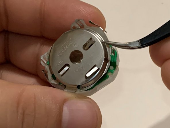

    • Use a pair of tweezers to pull the small metal tab and remove the interior of the watch.
  4. Casio A158WA-1 Watch Circuit Board Replacement: crwdns2935265:04crwdnd2935265:01crwdnd2935265:02crwdne2935265:0 Casio A158WA-1 Watch Circuit Board Replacement: crwdns2935265:04crwdnd2935265:02crwdnd2935265:02crwdne2935265:0

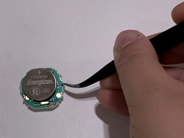

    • Use a pair of tweezers to lift the metal clasps at each corner and remove the battery holder.
  5. Casio A158WA-1 Watch Circuit Board Replacement: crwdns2935265:05crwdnd2935265:01crwdnd2935265:01crwdne2935265:0

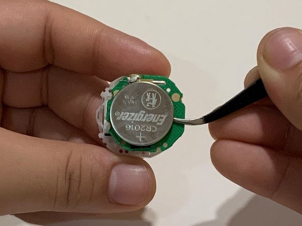

    • Separate the LCD from the circuit board.
  6. Casio A158WA-1 Watch Circuit Board Replacement: crwdns2935265:06crwdnd2935265:01crwdnd2935265:01crwdne2935265:0
    • Remember the position of the battery for reassembly.
    • Detach the battery from the circuit board.
  7. Casio A158WA-1 Watch Circuit Board Replacement: crwdns2935265:07crwdnd2935265:01crwdnd2935265:01crwdne2935265:0
    • Attach the battery to the new circuit board.
