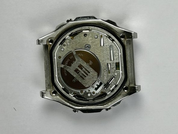

  3. Casio A1000 Battery Replacement: crwdns2935265:03crwdnd2935265:01crwdnd2935265:02crwdne2935265:0 Casio A1000 Battery Replacement: crwdns2935265:03crwdnd2935265:02crwdnd2935265:02crwdne2935265:0
    • Carefully remove the sticker that covers the battery with tweezers.
    • Be careful of your fingers because the ends of the tweezers are sharp.

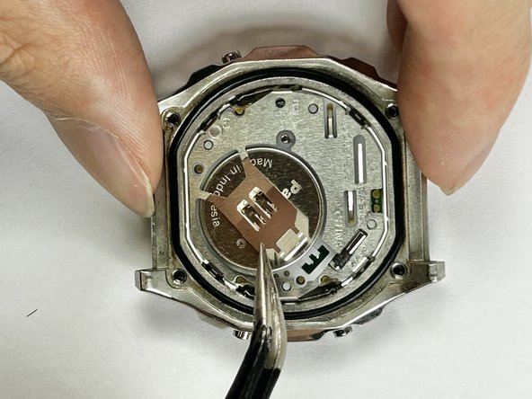

  4. Casio A1000 Battery Replacement: crwdns2935265:04crwdnd2935265:01crwdnd2935265:03crwdne2935265:0 Casio A1000 Battery Replacement: crwdns2935265:04crwdnd2935265:02crwdnd2935265:03crwdne2935265:0 Casio A1000 Battery Replacement: crwdns2935265:04crwdnd2935265:03crwdnd2935265:03crwdne2935265:0
    • Unhook the lever that holds the battery with tweezers.
    • Carefully remove the dead battery.

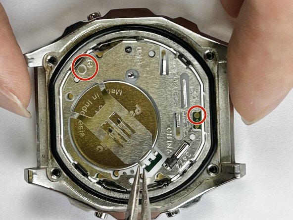

  5. Casio A1000 Battery Replacement: crwdns2935265:05crwdnd2935265:01crwdnd2935265:02crwdne2935265:0 Casio A1000 Battery Replacement: crwdns2935265:05crwdnd2935265:02crwdnd2935265:02crwdne2935265:0
    • Insert the new battery into the watch and engage the lever.
    • With your tweezers, reset the AC battery by contacting both the (+) and (AC) points at the same time
