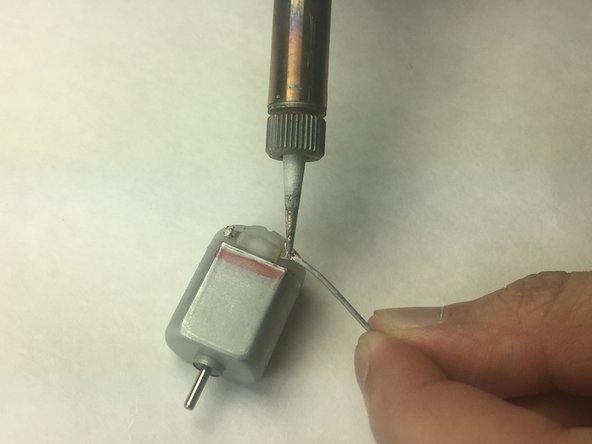

  11. Casdon Dyson Ball Air Cylinder Motor Replacement: crwdns2935265:011crwdnd2935265:01crwdnd2935265:01crwdne2935265:0
    • Cut wires connected to faulty motor using a set of wire cutters.
  12. Casdon Dyson Ball Air Cylinder Motor Replacement: crwdns2935265:012crwdnd2935265:01crwdnd2935265:02crwdne2935265:0 Casdon Dyson Ball Air Cylinder Motor Replacement: crwdns2935265:012crwdnd2935265:02crwdnd2935265:02crwdne2935265:0
    • Remove and replace faulty air cylinder motor.
    • Solder new air cylinder motor's wires to the vacuum's wires which were previously cut.
