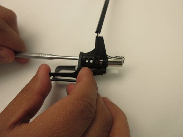

  10. Carrera Mario Copter Motor Replacement: crwdns2935265:010crwdnd2935265:01crwdnd2935265:02crwdne2935265:0 Carrera Mario Copter Motor Replacement: crwdns2935265:010crwdnd2935265:02crwdnd2935265:02crwdne2935265:0
    • Using the metal spudger of your choice, remove the clip at the top of the motor.
    • Use the thinner side of the spudger to push the motor through and out of the case.
  11. Carrera Mario Copter Motor Replacement: crwdns2935265:011crwdnd2935265:01crwdnd2935265:01crwdne2935265:0
    • Cut the connection head off and pull the wiring out of the leg.
