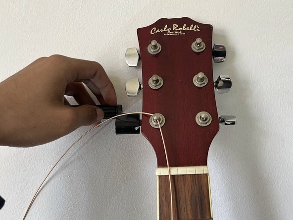

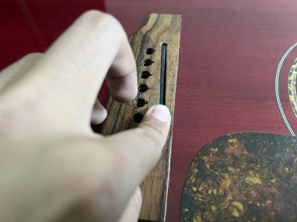

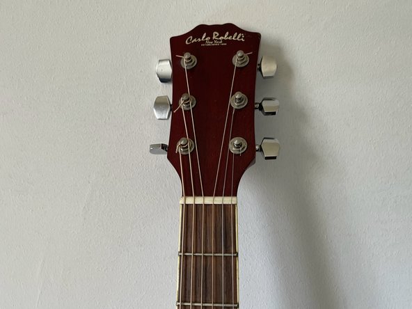

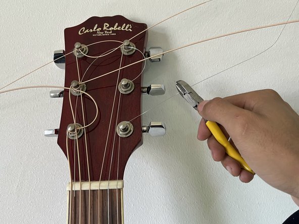

    • Unwind the low E guitar tuner with a guitar winder to loosen the string.
    • Cut the string above the sound hole using a string cutter.

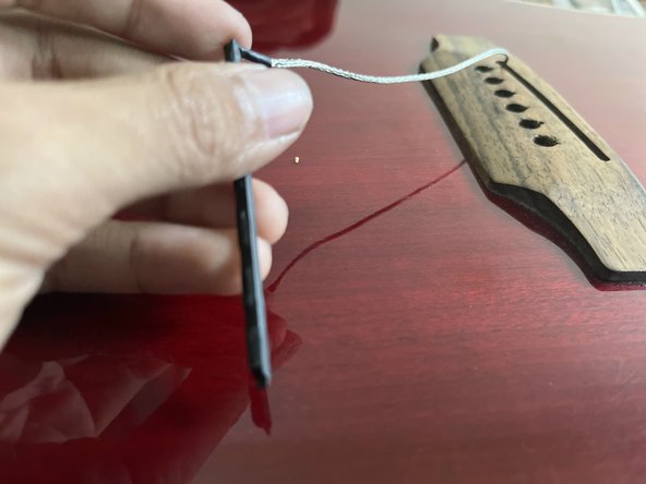

  2. Carlo Robelli CBW-4134CR Piezo Pickup Replacement: crwdns2935265:02crwdnd2935265:01crwdnd2935265:03crwdne2935265:0 Carlo Robelli CBW-4134CR Piezo Pickup Replacement: crwdns2935265:02crwdnd2935265:02crwdnd2935265:03crwdne2935265:0 Carlo Robelli CBW-4134CR Piezo Pickup Replacement: crwdns2935265:02crwdnd2935265:03crwdnd2935265:03crwdne2935265:0

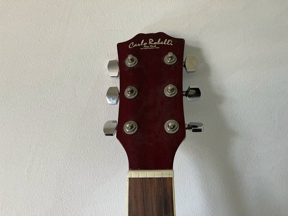

    • Remove the low E string from the guitar tuner and remove the bridge pin.
  3. Carlo Robelli CBW-4134CR Piezo Pickup Replacement: crwdns2935265:03crwdnd2935265:01crwdnd2935265:03crwdne2935265:0 Carlo Robelli CBW-4134CR Piezo Pickup Replacement: crwdns2935265:03crwdnd2935265:02crwdnd2935265:03crwdne2935265:0 Carlo Robelli CBW-4134CR Piezo Pickup Replacement: crwdns2935265:03crwdnd2935265:03crwdnd2935265:03crwdne2935265:0
    • Repeat Steps 1 and 2 for the rest of the guitar strings, removing all the pins and strings.
    • Remove the bridge saddle.

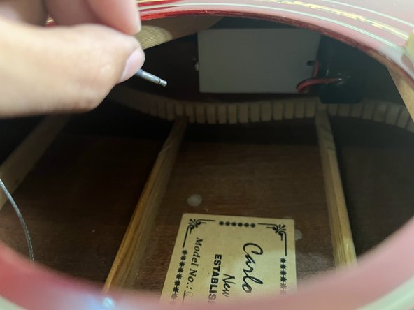

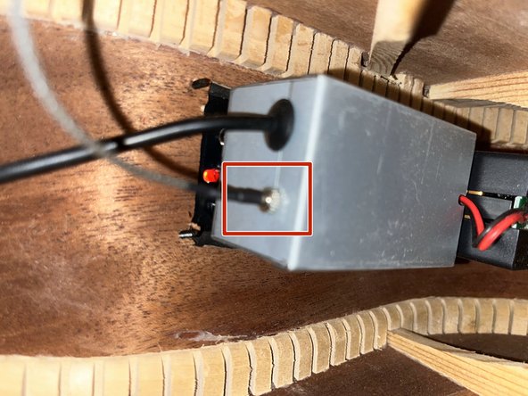

    • Find the preamp box inside the guitar soundhole and disconnect the piezo pickup only.
  5. Carlo Robelli CBW-4134CR Piezo Pickup Replacement: crwdns2935265:05crwdnd2935265:01crwdnd2935265:03crwdne2935265:0 Carlo Robelli CBW-4134CR Piezo Pickup Replacement: crwdns2935265:05crwdnd2935265:02crwdnd2935265:03crwdne2935265:0 Carlo Robelli CBW-4134CR Piezo Pickup Replacement: crwdns2935265:05crwdnd2935265:03crwdnd2935265:03crwdne2935265:0

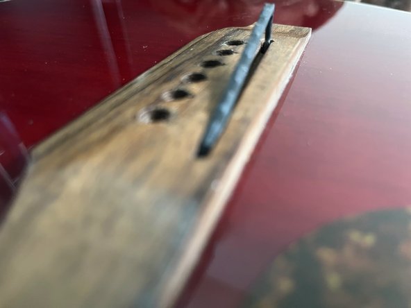

    • Inside the guitar, find the piezo pickup and push outward.
    • Once the pickup is sticking out, pull to remove it.

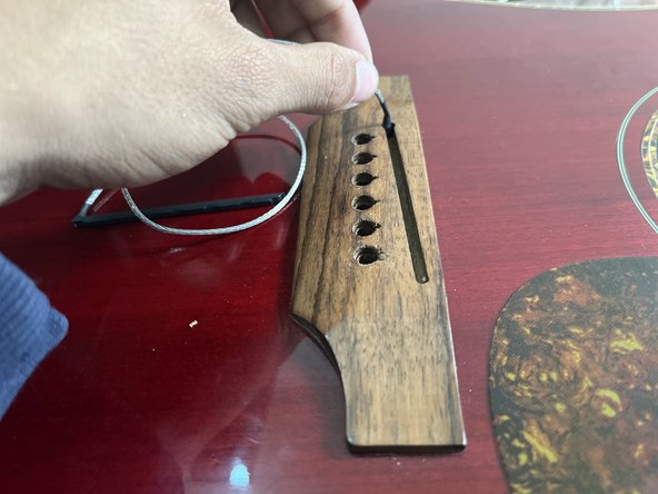

    • Grab the new piezo pickup and insert it in the designated hole, pressing firmly and ensuring it is neatly tucked in.

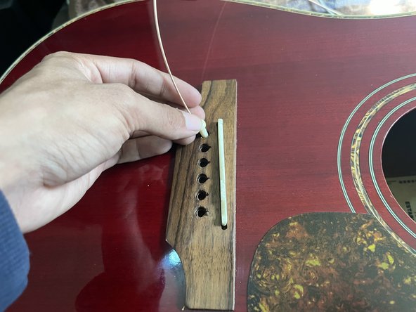

    • Place the bridge saddle back in place.
    • Insert a new set of strings with guitar pins to ensure that the line is not pulled out when winding the new guitar strings.

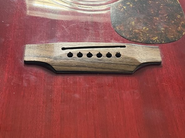

  10. Carlo Robelli CBW-4134CR Piezo Pickup Replacement: crwdns2935265:010crwdnd2935265:01crwdnd2935265:01crwdne2935265:0
    • This is how the bridge should look once everything is back into place.
Having a new piezo pickup will heavily improve the sound quality sent from your guitar to the guitar amplifier, recording interface, PA system, or headphones.
