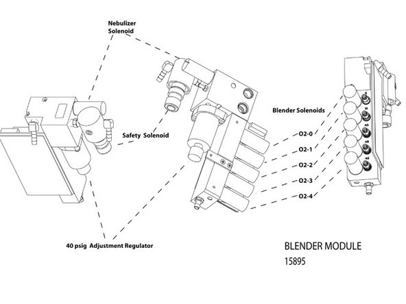

  6. Cardinal Health Vela Ventilator Turbine/Muffler Assembly P/N 16349 Replacement, Blender Assembly P/N 16358A: crwdns2935265:013crwdnd2935265:01crwdnd2935265:01crwdne2935265:0

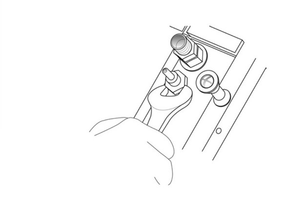

    • If the rear panel is installed, remove the high and low pressure oxygen fittings from the rear panel using your 3/4" wrench. NOTE: the high pressure fitting is located above the low pressure fitting

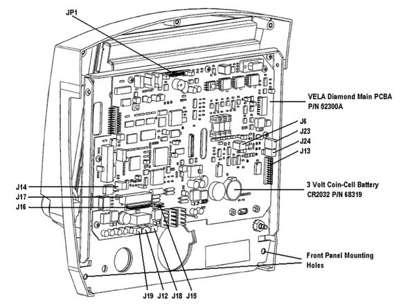

    • If the rear panel is installed, disconnect the 40-pin ribbon cable from the SVGA out PCB.

    • -J301, 12-Pin Connector to J301 on the main PCB
    • From the blender PCB

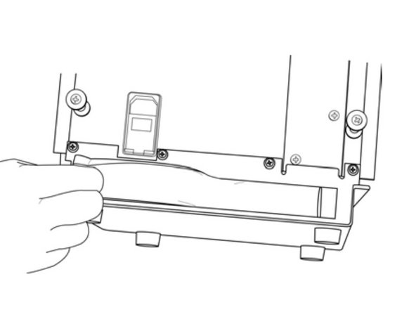

    • Remove the bottom strip ambient air inlet filter by pinching and pulling it out.

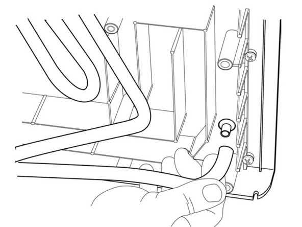

    • The assembly should now be free to remove. As you remove the unit use your needle-nose pliers to disconnect the oxygen diffuser tube as you remove the blender assembly.

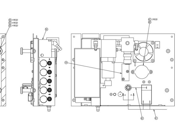

  12. Cardinal Health Vela Ventilator Turbine/Muffler Assembly P/N 16349 Replacement: crwdns2935265:023crwdnd2935265:01crwdnd2935265:01crwdne2935265:0
    • Remove the 5 Phillips pan-head mounting screws.
    • Disconnect the gray silicone intake and output elbows by gently pulling them out from the muffler tubes.
    • The Turbine/Muffler Assembly should now be free to lift off the manifold base.
    • Gently pull up on the elbows to remove
    • To Install P/N 16350 "Turbine/Muffler Assembly" repeat the steps in reverse order.
