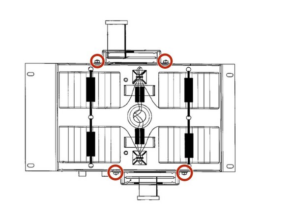

    • Use a screwdriver to remove the two Phillips pan-head screws at the top of the plug guard.
    • Remove the plug guard and unplug the ventilator.
  2. Cardinal Health Vela Ventilator Left Panel Replacement, Cardinal Health Vela Ventilator Top Cover Disassembly: crwdns2935265:03crwdnd2935265:01crwdnd2935265:01crwdne2935265:0
    • Remove the four Phillips #0 screws on the back side of the ventilator.
  3. Cardinal Health Vela Ventilator Left Panel Replacement: crwdns2935265:04crwdnd2935265:01crwdnd2935265:01crwdne2935265:0
    • Remove all six small side panel screws along the bottom of each side of the top cover with the same screwdriver.
    • Slide the top cover towards the back side of the ventilator to remove it.

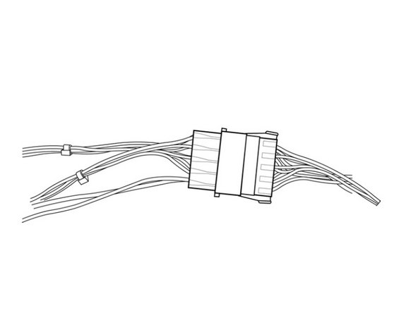

  5. Cardinal Health Vela Ventilator Left Panel Replacement: crwdns2935265:08crwdnd2935265:01crwdnd2935265:01crwdne2935265:0
    • Disconnect the batteries from the ventilator by pulling apart the Battery Connector.
    • Remove the two Phillips countersink at the rear of the panel.
    • Remove the Phillips countersink in the upper front of the panel.
    • The panel is now free and can be lifted from the device.
    • To install the left panel follow these steps in reverse order.
