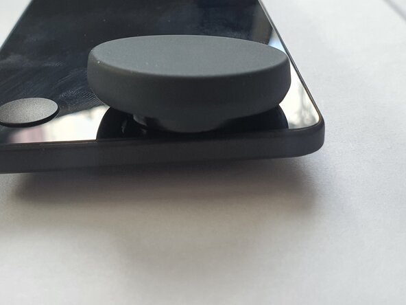

    • The dial on the car thing is clipped on with a plastic insert in the dial rubber cover.
    • It is easy to pull off, be gentle and you should be able to pry it off with your fingers.
    • Be careful using metal tools as it may scratch or crack the glass.

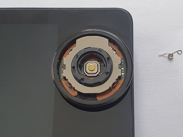

    • Using a small flathead screwdriver or pair of tweezers, gently work your way around the silver shield to pry it off.
    • It is held around 4 corners with clips.
    • To use the clip I recommend bending the tabs backwards to make installation easier.
  3. Car Thing dial spring removal and contacts cleaning, Get rid of the spring!: crwdns2935265:03crwdnd2935265:01crwdnd2935265:01crwdne2935265:0
    • At this point if you want to remove the spring to enjoy a smooth feel on your dial, remove the spring.
    • If you do want to retain your clicky feel, you can reinstall it after cleaning the contacts.
  4. Car Thing dial spring removal and contacts cleaning, Clean the contacts: crwdns2935265:04crwdnd2935265:01crwdnd2935265:02crwdne2935265:0 Car Thing dial spring removal and contacts cleaning, Clean the contacts: crwdns2935265:04crwdnd2935265:02crwdnd2935265:02crwdne2935265:0
    • Using a cotton bud, dab the contacts in some isopropyl alcohol to clean any debris or grease that can interfere with the dial making contact.
    • Don't forget to also clean the brushes (ring with metal contacts sticking up)
    • You can VERY slightly bend the metal tabs up to help maintain contact. Be very gentle to not break this.
