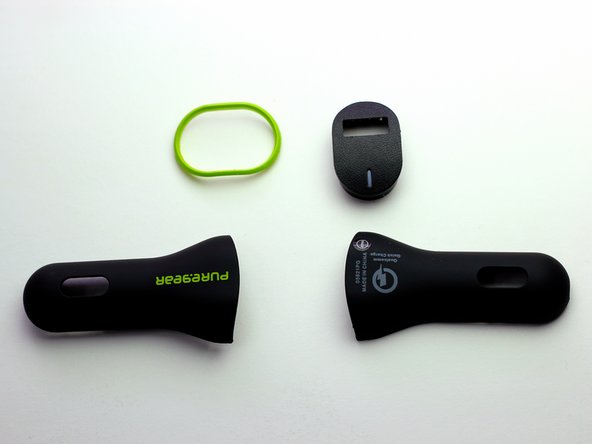

    • To separate the last part of the outer shell, we need to apply some pressure from with the vice grip pliers.
    • Squeezing the shell across the seem causes the connecting tabs to separate enough for us to pry them apart.
    • Inside the shell are three metal leads that fell out when the shell pieces separated.

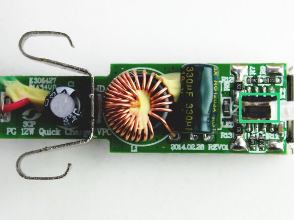

    • Finally we can see what makes this charger tick and It seems that there are two important chips at work here:
    • Active-Semi ACT4533C DC/DC Converter
    • Power Integrations CHY100D-TL Battery Management Charger Interface
    • These two chips in tandem make this CLA possible with so few parts, including:
    • a couple resistors and capacitors
    • an inductor
    • a fuse
    • and two diodes
