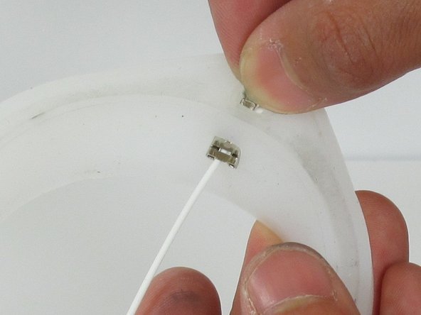

    1. Capresso Perfectea 260 Heating Dome Replacement, Heating Dome: crwdns2935265:07crwdnd2935265:01crwdnd2935265:03crwdne2935265:0 Capresso Perfectea 260 Heating Dome Replacement, Heating Dome: crwdns2935265:07crwdnd2935265:02crwdnd2935265:03crwdne2935265:0 Capresso Perfectea 260 Heating Dome Replacement, Heating Dome: crwdns2935265:07crwdnd2935265:03crwdnd2935265:03crwdne2935265:0
      • The bottom panel has four wires that latch on to four tabs.
      • Use the metal spudger to pry up one metal tab in the latch.
      • Apply pressure with the metal spudger to the other tab on the latch to slide off tab.
      • Repeat for the remaining three tabs.
      • The bottom panel should now be disconnected from the rest of the kettle.
      • Take note of which cable attaches to which tab so that you will remember how to reconnect the wires properly. Using masking tape to mark which wire goes to which terminal is helpful.
      • Do not push tabs too forcefully otherwise you may damage your device or impale yourself.

    6. Capresso Perfectea 260 Heating Dome Replacement: crwdns2935265:012crwdnd2935265:01crwdnd2935265:02crwdne2935265:0 Capresso Perfectea 260 Heating Dome Replacement: crwdns2935265:012crwdnd2935265:02crwdnd2935265:02crwdne2935265:0
      • Peel the seal off of the heating element.
      • Draw the two temperature probe wires through the seal.
