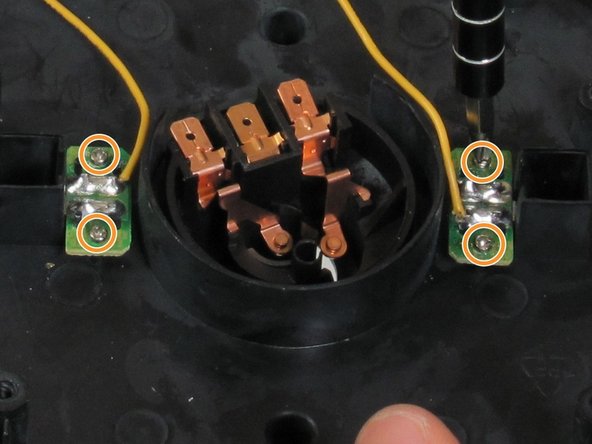

    • Identify the two computer chips that connect the two yellow wires to the temperature controls.
    • Remove the four 5 mm Phillips #1 screws.
    • Remove the two computer chips from their places.
    • The two computer chips are held in place by plastic interference pins. Wiggle the board free of these pins to remove.
