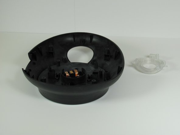

  12. Capresso PerfecTea 260 Dial Replacement: crwdns2935265:012crwdnd2935265:01crwdnd2935265:01crwdne2935265:0
    • Unplug the four cables on the left side of the chip.
    • Remember which cable goes to which plug.
  13. Capresso PerfecTea 260 Dial Replacement, Dial: crwdns2935265:013crwdnd2935265:01crwdnd2935265:03crwdne2935265:0 Capresso PerfecTea 260 Dial Replacement, Dial: crwdns2935265:013crwdnd2935265:02crwdnd2935265:03crwdne2935265:0 Capresso PerfecTea 260 Dial Replacement, Dial: crwdns2935265:013crwdnd2935265:03crwdnd2935265:03crwdne2935265:0
    • Remove the two 6 mm Phillips #1 screws from the black dial base plate.
    • 6 mm Phillips #1 screws
    • Remove the black dial base plate, metal spring, LED tube, and the actual dial.
  14. Capresso PerfecTea 260 Dial Replacement: crwdns2935265:014crwdnd2935265:01crwdnd2935265:02crwdne2935265:0 Capresso PerfecTea 260 Dial Replacement: crwdns2935265:014crwdnd2935265:02crwdnd2935265:02crwdne2935265:0
    • Remove the three 7.5 mm Phillips #2 screws from the dial collar.
    • 7.5 mm Phillips #2 screws
    • The dial collar will then come away from the base.
