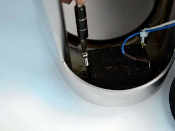

    6. Capresso Infinity Timer/On Switch Replacement: crwdns2935265:06crwdnd2935265:01crwdnd2935265:03crwdne2935265:0 Capresso Infinity Timer/On Switch Replacement: crwdns2935265:06crwdnd2935265:02crwdnd2935265:03crwdne2935265:0 Capresso Infinity Timer/On Switch Replacement: crwdns2935265:06crwdnd2935265:03crwdnd2935265:03crwdne2935265:0
      • Remove one 11.59mm T10 screw.
      • Let the green wire fall, or place somewhere so it doesn't get in the way.
      • There will be a small metal retainer and washer, put them aside for reassembly.
    7. Capresso Infinity Timer/On Switch Replacement: crwdns2935265:07crwdnd2935265:01crwdnd2935265:03crwdne2935265:0 Capresso Infinity Timer/On Switch Replacement: crwdns2935265:07crwdnd2935265:02crwdnd2935265:03crwdne2935265:0 Capresso Infinity Timer/On Switch Replacement: crwdns2935265:07crwdnd2935265:03crwdnd2935265:03crwdne2935265:0
      • Remove two 11.59mm T10 screws.
    8. Capresso Infinity Timer/On Switch Replacement: crwdns2935265:08crwdnd2935265:01crwdnd2935265:02crwdne2935265:0 Capresso Infinity Timer/On Switch Replacement: crwdns2935265:08crwdnd2935265:02crwdnd2935265:02crwdne2935265:0
      • Remove the time/on switch by pulling upwards.
