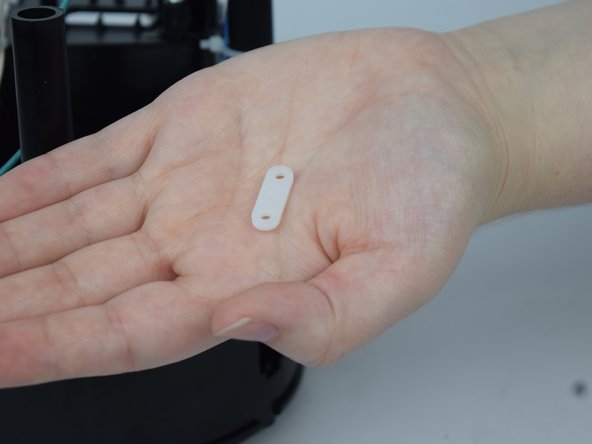

  9. Capresso Infinity Power Cord Replacement, Power Cord: crwdns2935265:09crwdnd2935265:01crwdnd2935265:03crwdne2935265:0 Capresso Infinity Power Cord Replacement, Power Cord: crwdns2935265:09crwdnd2935265:02crwdnd2935265:03crwdne2935265:0 Capresso Infinity Power Cord Replacement, Power Cord: crwdns2935265:09crwdnd2935265:03crwdnd2935265:03crwdne2935265:0
    • Remove two 13.60mm T10 screws.
    • A white, flat plastic piece will have come loose. Place this to the side for reassembly.

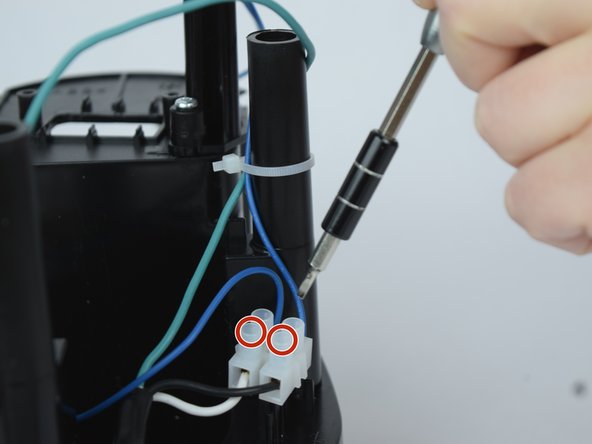

  10. Capresso Infinity Power Cord Replacement: crwdns2935265:010crwdnd2935265:01crwdnd2935265:03crwdne2935265:0 Capresso Infinity Power Cord Replacement: crwdns2935265:010crwdnd2935265:02crwdnd2935265:03crwdne2935265:0 Capresso Infinity Power Cord Replacement: crwdns2935265:010crwdnd2935265:03crwdnd2935265:03crwdne2935265:0
    • Using a Flathead screwdriver loosen the two screws connecting the white and black wire to the plastic box.
    • Do not remove the screws from the box, but loosen them enough to disconnect the black and white wire.

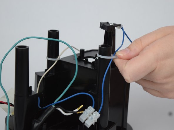

  11. Capresso Infinity Power Cord Replacement: crwdns2935265:011crwdnd2935265:01crwdnd2935265:03crwdne2935265:0 Capresso Infinity Power Cord Replacement: crwdns2935265:011crwdnd2935265:02crwdnd2935265:03crwdne2935265:0 Capresso Infinity Power Cord Replacement: crwdns2935265:011crwdnd2935265:03crwdnd2935265:03crwdne2935265:0
    • Originally attached to the inside of the outer casing, the green wire needs to be fed through the zip tie which keeps it in place.
    • Lift up on the zip tie far enough to create a space to feed the green wire through.
    • Place the zip tie back around the column that you lifted it from.
    • All three wires that comprise the power cord should be detached from the coffee grinder.
