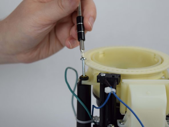

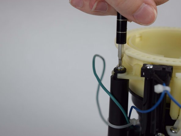

    • Remove the three 19.61 mm T10 screws surrounding the white plastic burr housing.
  17. Capresso Infinity Motor Replacement: crwdns2935265:017crwdnd2935265:01crwdnd2935265:02crwdne2935265:0 Capresso Infinity Motor Replacement: crwdns2935265:017crwdnd2935265:02crwdnd2935265:02crwdne2935265:0
    • Pry up the gold colored screw castings for each hole using a spudger.
    • Remove all three gold castings and set them aside for reassembly.

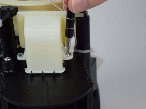

  18. Capresso Infinity Motor Replacement: crwdns2935265:018crwdnd2935265:01crwdnd2935265:03crwdne2935265:0 Capresso Infinity Motor Replacement: crwdns2935265:018crwdnd2935265:02crwdnd2935265:03crwdne2935265:0 Capresso Infinity Motor Replacement: crwdns2935265:018crwdnd2935265:03crwdnd2935265:03crwdne2935265:0
    • Remove the two 13.60 mm T10 screws holding the bean chute to the base.

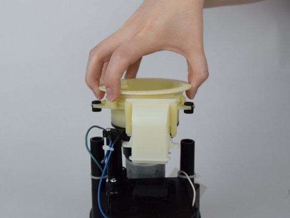

  19. Capresso Infinity Motor Replacement: crwdns2935265:019crwdnd2935265:01crwdnd2935265:03crwdne2935265:0 Capresso Infinity Motor Replacement: crwdns2935265:019crwdnd2935265:02crwdnd2935265:03crwdne2935265:0 Capresso Infinity Motor Replacement: crwdns2935265:019crwdnd2935265:03crwdnd2935265:03crwdne2935265:0
    • Pull the white plastic burr housing and motor up and out of the base.
    • Place the motor and white plastic burr housing aside for future soldering.

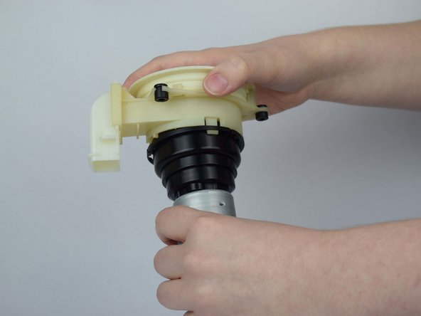

  22. Capresso Infinity Motor Replacement: crwdns2935265:022crwdnd2935265:01crwdnd2935265:03crwdne2935265:0 Capresso Infinity Motor Replacement: crwdns2935265:022crwdnd2935265:02crwdnd2935265:03crwdne2935265:0 Capresso Infinity Motor Replacement: crwdns2935265:022crwdnd2935265:03crwdnd2935265:03crwdne2935265:0
    • Locate the three knobs preventing the white plastic burr housing from being removed from the motor. They are all along the seam.
    • Pry the seam between the two pieces down enough to allow each knob to slide counterclockwise with an opening tool.
    • Twist the white plastic burr housing as far counterclockwise as you can.

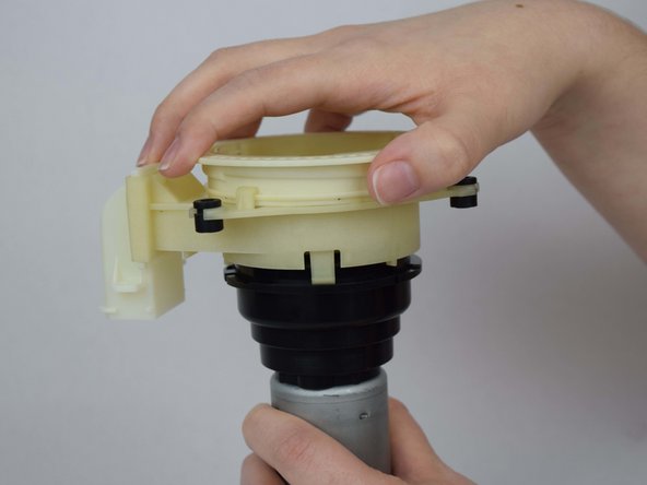

  23. Capresso Infinity Motor Replacement: crwdns2935265:023crwdnd2935265:01crwdnd2935265:03crwdne2935265:0 Capresso Infinity Motor Replacement: crwdns2935265:023crwdnd2935265:02crwdnd2935265:03crwdne2935265:0 Capresso Infinity Motor Replacement: crwdns2935265:023crwdnd2935265:03crwdnd2935265:03crwdne2935265:0
    • Lift up the white plastic burr housing and separate it from the motor.
    • The black plastic piece is attached to the motor. You need to remove the motor with it for replacement.
