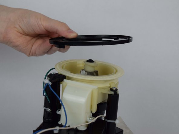

  9. Capresso Infinity Bottom Conical Burr Replacement, Bottom Conical Burr: crwdns2935265:09crwdnd2935265:01crwdnd2935265:02crwdne2935265:0 Capresso Infinity Bottom Conical Burr Replacement, Bottom Conical Burr: crwdns2935265:09crwdnd2935265:02crwdnd2935265:02crwdne2935265:0
    • Grab the edge of the plastic black ring that sits on top of the device and gently pull up to release.

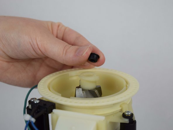

  10. Capresso Infinity Bottom Conical Burr Replacement: crwdns2935265:010crwdnd2935265:01crwdnd2935265:02crwdne2935265:0 Capresso Infinity Bottom Conical Burr Replacement: crwdns2935265:010crwdnd2935265:02crwdnd2935265:02crwdne2935265:0
    • Remove the black rubber knob atop the bottom burr by gently pulling up.

Step 9, It is essential to mark the location of black plastic ring in regards to white plastic part with holes AND in regards to ex. white square plastic part before removing part. Othervise you can’t assemble or you could destroy the burrs when you adjust the grinder to very fine grinds
