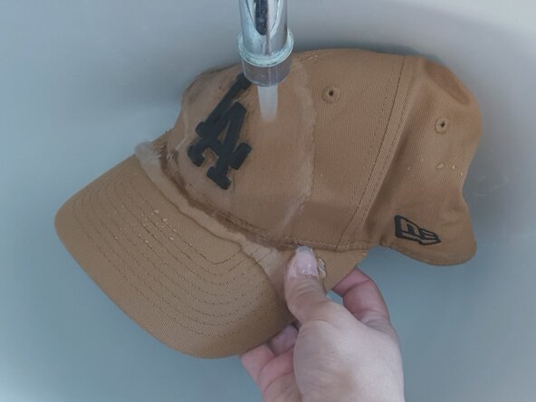

      • Wash the cap using an old toothbrush to remove residue and stains.
      • You can use dish soap or detergent to assist with the cleaning process.

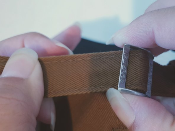

      • Tighten the clip or snaps of the cap to fix the pot/bowl and plastic bags into place.
