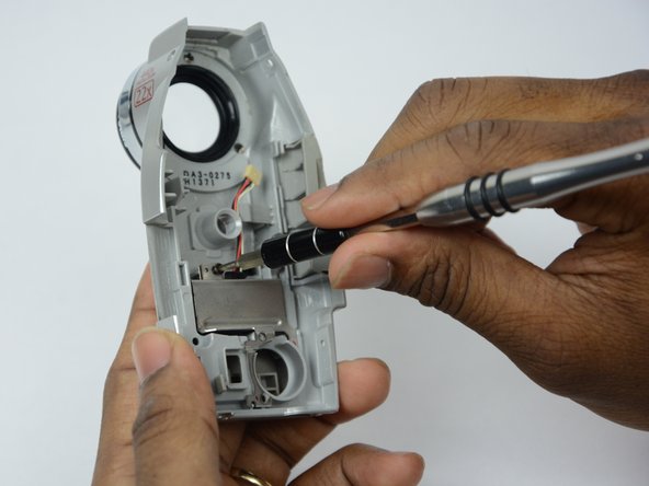

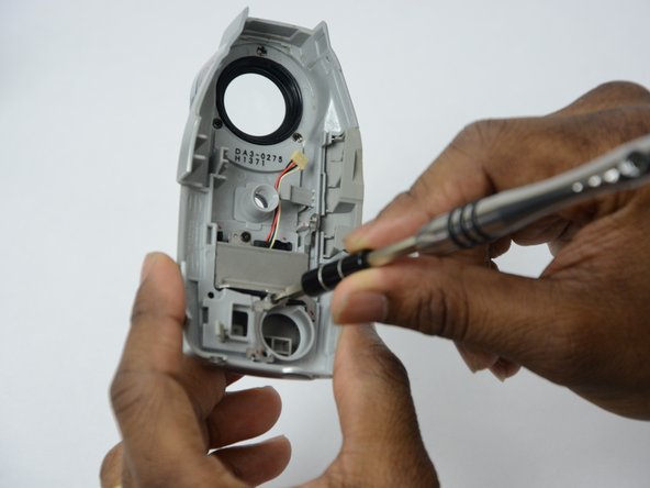

  8. Canon ZR70MC Speaker Replacement, Speaker: crwdns2935265:08crwdnd2935265:01crwdnd2935265:03crwdne2935265:0 Canon ZR70MC Speaker Replacement, Speaker: crwdns2935265:08crwdnd2935265:02crwdnd2935265:03crwdne2935265:0 Canon ZR70MC Speaker Replacement, Speaker: crwdns2935265:08crwdnd2935265:03crwdnd2935265:03crwdne2935265:0
    • Take the front panel and remove the three 2.75 mm screws from the metal plate.

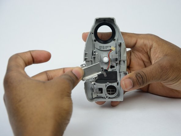

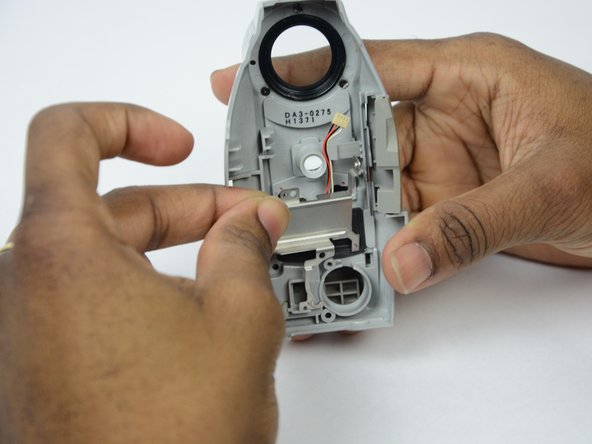

  9. Canon ZR70MC Speaker Replacement: crwdns2935265:09crwdnd2935265:01crwdnd2935265:03crwdne2935265:0 Canon ZR70MC Speaker Replacement: crwdns2935265:09crwdnd2935265:02crwdnd2935265:03crwdne2935265:0 Canon ZR70MC Speaker Replacement: crwdns2935265:09crwdnd2935265:03crwdnd2935265:03crwdne2935265:0
    • Remove the metal plate. This metal plate protects the black speaker holder.

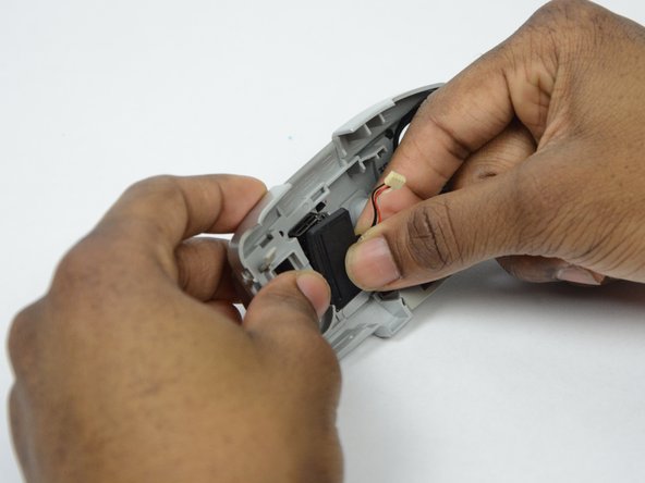

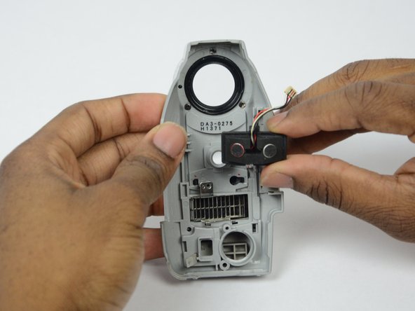

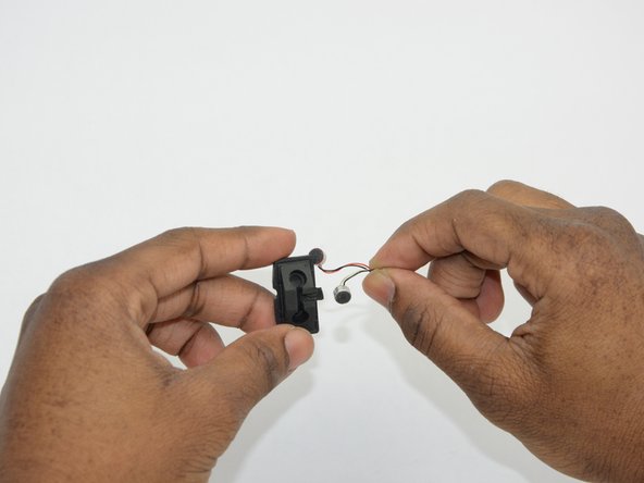

  10. Canon ZR70MC Speaker Replacement: crwdns2935265:010crwdnd2935265:01crwdnd2935265:03crwdne2935265:0 Canon ZR70MC Speaker Replacement: crwdns2935265:010crwdnd2935265:02crwdnd2935265:03crwdne2935265:0 Canon ZR70MC Speaker Replacement: crwdns2935265:010crwdnd2935265:03crwdnd2935265:03crwdne2935265:0
    • Remove the black speaker holder from the front panel. This holds the individual speakers.

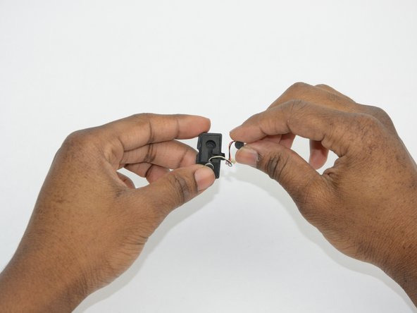

  11. Canon ZR70MC Speaker Replacement: crwdns2935265:011crwdnd2935265:01crwdnd2935265:03crwdne2935265:0 Canon ZR70MC Speaker Replacement: crwdns2935265:011crwdnd2935265:02crwdnd2935265:03crwdne2935265:0 Canon ZR70MC Speaker Replacement: crwdns2935265:011crwdnd2935265:03crwdnd2935265:03crwdne2935265:0
    • Remove the individual speakers from the black speaker holder.
