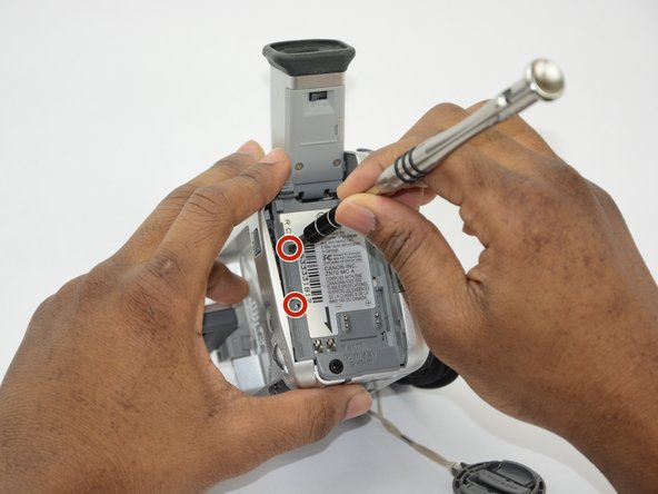

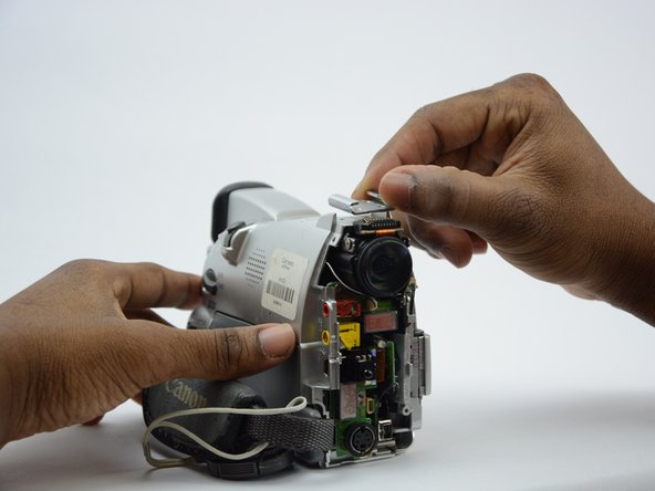

  4. Canon ZR70MC Lens Replacement: crwdns2935265:04crwdnd2935265:01crwdnd2935265:03crwdne2935265:0 Canon ZR70MC Lens Replacement: crwdns2935265:04crwdnd2935265:02crwdnd2935265:03crwdne2935265:0 Canon ZR70MC Lens Replacement: crwdns2935265:04crwdnd2935265:03crwdnd2935265:03crwdne2935265:0
    • Remove the cover located on the front of the camcorder and remove the cover by pulling on the bottom groove.
    • Locate and remove the two 3.35 mm screws.

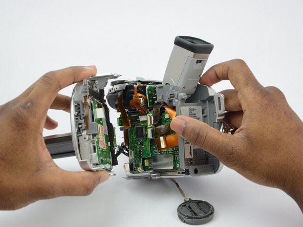

  10. Canon ZR70MC Lens Replacement: crwdns2935265:010crwdnd2935265:01crwdnd2935265:02crwdne2935265:0 Canon ZR70MC Lens Replacement: crwdns2935265:010crwdnd2935265:02crwdnd2935265:02crwdne2935265:0
    • Now that all of the screws are removed, gently pull off the side panel of the camcorder.
  11. Canon ZR70MC Lens Replacement: crwdns2935265:011crwdnd2935265:01crwdnd2935265:02crwdne2935265:0 Canon ZR70MC Lens Replacement: crwdns2935265:011crwdnd2935265:02crwdnd2935265:02crwdne2935265:0
    • Gently pull the two black wires from their connections. These black wires are the only thing left connecting the side panel to the main body of the camcorder.
  12. Canon ZR70MC Lens Replacement: crwdns2935265:012crwdnd2935265:01crwdnd2935265:01crwdne2935265:0
    • Gently pull the orange films out of their connections. This will allow you access to all components of the main body.

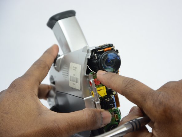

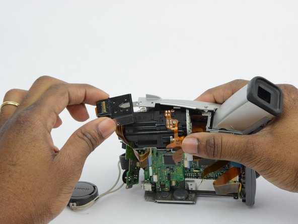

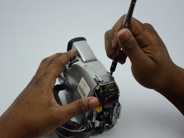

  13. Canon ZR70MC Lens Replacement, Lens: crwdns2935265:013crwdnd2935265:01crwdnd2935265:03crwdne2935265:0 Canon ZR70MC Lens Replacement, Lens: crwdns2935265:013crwdnd2935265:02crwdnd2935265:03crwdne2935265:0 Canon ZR70MC Lens Replacement, Lens: crwdns2935265:013crwdnd2935265:03crwdnd2935265:03crwdne2935265:0
    • Locate the four 3.5 mm screws on the top of the camcorder that holds the lens in place.
    • Remove the four 3.5 mm screws.
    • Remove the metal plate that the screws were holding down.

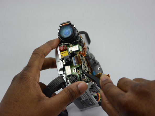

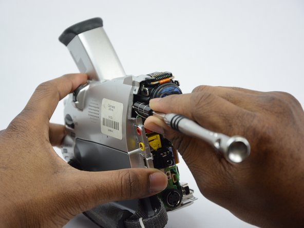

  14. Canon ZR70MC Lens Replacement: crwdns2935265:014crwdnd2935265:01crwdnd2935265:03crwdne2935265:0 Canon ZR70MC Lens Replacement: crwdns2935265:014crwdnd2935265:02crwdnd2935265:03crwdne2935265:0 Canon ZR70MC Lens Replacement: crwdns2935265:014crwdnd2935265:03crwdnd2935265:03crwdne2935265:0
    • Remove the first 2.75 mm screw that holds the lens in place.
    • The second 2.75 mm screw that holds the lens n place is difficult to see. If you look directly into the "hole" beside the lens you will see the 2.75 mm screw.
    • Remove the second 2.75 mm screw.

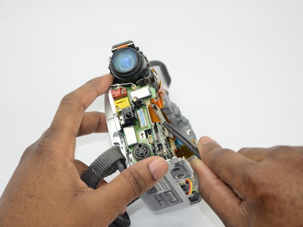

  15. Canon ZR70MC Lens Replacement: crwdns2935265:015crwdnd2935265:01crwdnd2935265:03crwdne2935265:0 Canon ZR70MC Lens Replacement: crwdns2935265:015crwdnd2935265:02crwdnd2935265:03crwdne2935265:0 Canon ZR70MC Lens Replacement: crwdns2935265:015crwdnd2935265:03crwdnd2935265:03crwdne2935265:0

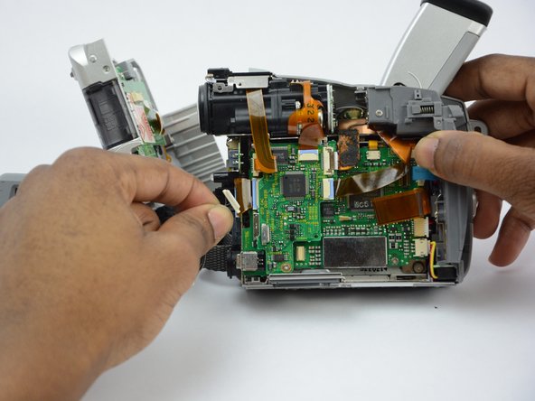

    • Turn the camera so that you can see the orange film that needs to be pulled away.
    • Use tweezers to gently pull the orange film away from the connection.

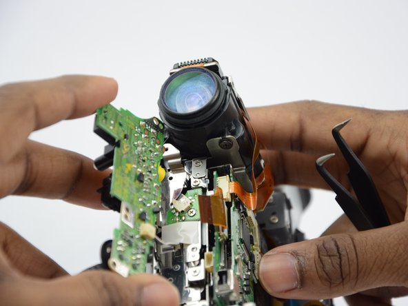

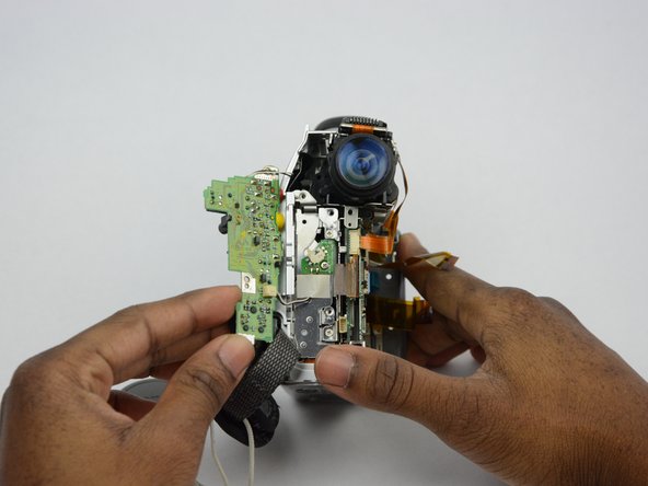

  16. Canon ZR70MC Lens Replacement: crwdns2935265:016crwdnd2935265:01crwdnd2935265:03crwdne2935265:0 Canon ZR70MC Lens Replacement: crwdns2935265:016crwdnd2935265:02crwdnd2935265:03crwdne2935265:0 Canon ZR70MC Lens Replacement: crwdns2935265:016crwdnd2935265:03crwdnd2935265:03crwdne2935265:0
    • Use the tweezers to pull the green circuit board away from the main body of the camcorder.
    • Pull out the white wire from its connection so that the green circuit board can be completely removed form the main body of the camcorder.
    • Removing this green circuit board allows access to the camcorder lens.
  17. Canon ZR70MC Lens Replacement: crwdns2935265:017crwdnd2935265:01crwdnd2935265:02crwdne2935265:0 Canon ZR70MC Lens Replacement: crwdns2935265:017crwdnd2935265:02crwdnd2935265:02crwdne2935265:0

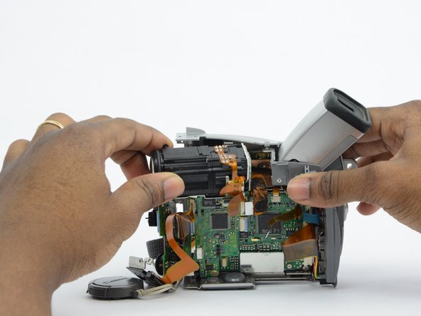

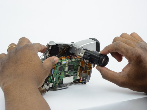

    • Remove the final black metal plate that is holding the lens in place.
  18. Canon ZR70MC Lens Replacement: crwdns2935265:018crwdnd2935265:01crwdnd2935265:03crwdne2935265:0 Canon ZR70MC Lens Replacement: crwdns2935265:018crwdnd2935265:02crwdnd2935265:03crwdne2935265:0 Canon ZR70MC Lens Replacement: crwdns2935265:018crwdnd2935265:03crwdnd2935265:03crwdne2935265:0
    • Remove the camcorder lens.
