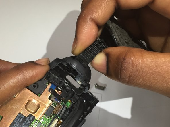

    • Flip the camcorder upside down and remove the four 2.5 mm Phillips #00 screws from the bottom of the camera and two 2.5 mm screws from the top of the camera.
    • Unhook the strap.
  2. Canon Vixia HF S10 Camcorder Strap Replacement: crwdns2935265:02crwdnd2935265:01crwdnd2935265:03crwdne2935265:0 Canon Vixia HF S10 Camcorder Strap Replacement: crwdns2935265:02crwdnd2935265:02crwdnd2935265:03crwdne2935265:0 Canon Vixia HF S10 Camcorder Strap Replacement: crwdns2935265:02crwdnd2935265:03crwdnd2935265:03crwdne2935265:0
    • Using a plastic opening tool, outline the edges.
    • Remove the plastic casing.
    • Remove the single 2.5 mm Phillips #00 screw securing the silver plate.
  3. Canon Vixia HF S10 Camcorder Strap Replacement: crwdns2935265:03crwdnd2935265:01crwdnd2935265:02crwdne2935265:0 Canon Vixia HF S10 Camcorder Strap Replacement: crwdns2935265:03crwdnd2935265:02crwdnd2935265:02crwdne2935265:0
    • Using your fingers, remove the silver plate.
    • Remove the strap to have it replaced.
