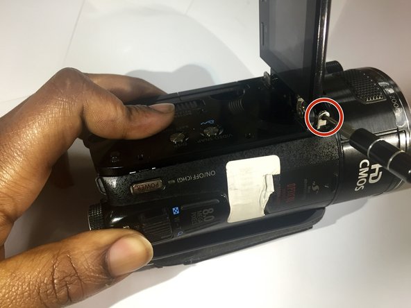

    • Open the LCD screen.
    • Remove the three 3x4 mm Phillips screws that hold the black panel plastic case together.
    • Remove the two 2x2.5 mm Phillips screws and the 3x4 mm Phillips screw from the inner corner between the panel and the LCD screen.

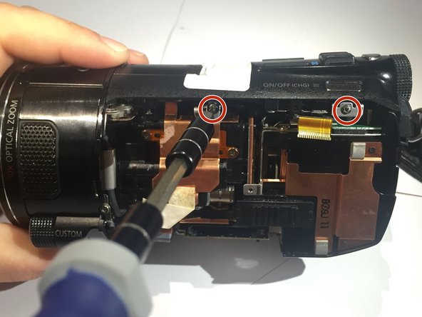

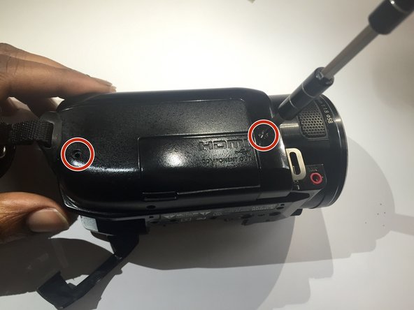

  8. Canon Vixia HF S10 Camcorder Power Button Replacement: crwdns2935265:08crwdnd2935265:01crwdnd2935265:01crwdne2935265:0

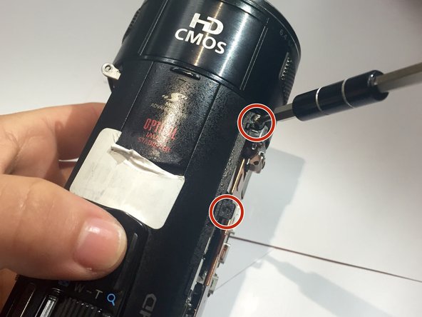

    • Remove the two 3x4 mm Phillips screws beneath the two covers (AV & DCIN).
  9. Canon Vixia HF S10 Camcorder Power Button Replacement: crwdns2935265:09crwdnd2935265:01crwdnd2935265:03crwdne2935265:0 Canon Vixia HF S10 Camcorder Power Button Replacement: crwdns2935265:09crwdnd2935265:02crwdnd2935265:03crwdne2935265:0 Canon Vixia HF S10 Camcorder Power Button Replacement: crwdns2935265:09crwdnd2935265:03crwdnd2935265:03crwdne2935265:0

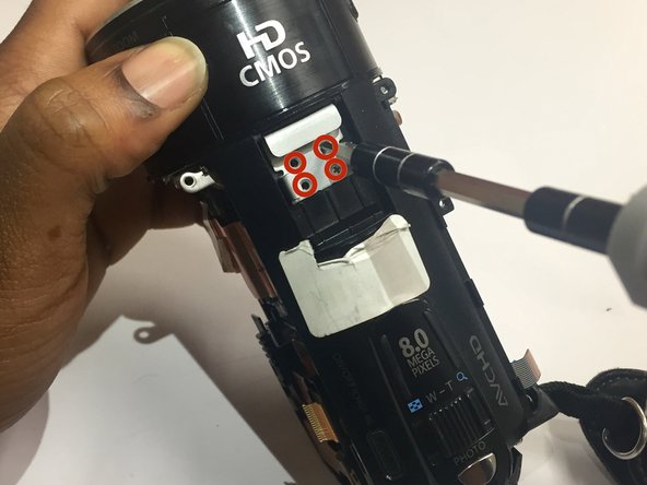

    • Slide open the "Optical Image Stabilizer" cover located at the top of the camcorder.
    • Remove the four 3x2.5 mm Phillips screws.
    • Using your fingers, remove the metal casing.

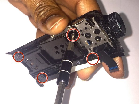

    • Using your fingers pop off the top cover of the camcorder.
    • Remove the three 3x4 mm Phillips screws and one 2x2.5 mm Phillips screw located beneath the top cover.
    • Remove the two 3x2.5 mm Phillips screws from the metal casing located underneath the top cover.

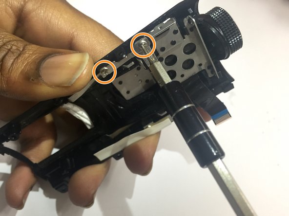

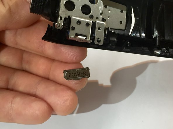

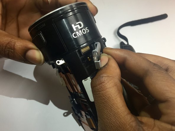

  11. Canon Vixia HF S10 Camcorder Power Button Replacement: crwdns2935265:011crwdnd2935265:01crwdnd2935265:02crwdne2935265:0 Canon Vixia HF S10 Camcorder Power Button Replacement: crwdns2935265:011crwdnd2935265:02crwdnd2935265:02crwdne2935265:0
    • Using your fingers, slightly move the metal casing.
    • Remove the power button.
