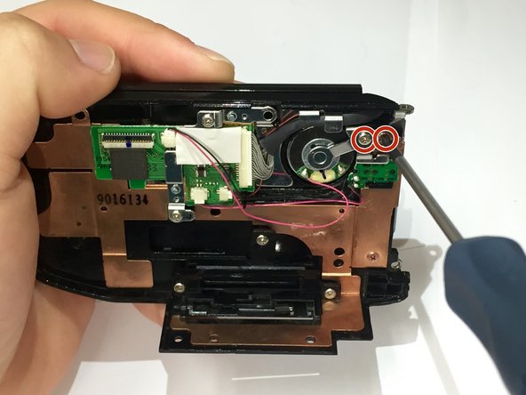

    • Using your fingers, remove the panel from the base of the camcorder.
    • After removing the panel, remove the two 2x2.25 mm Phillips screws located at the top right of the inside of the panel.

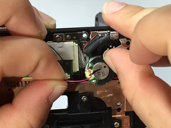

    • Using one hand, gently move the silver piece holding the speaker down while using the other hand to remove the speaker.
