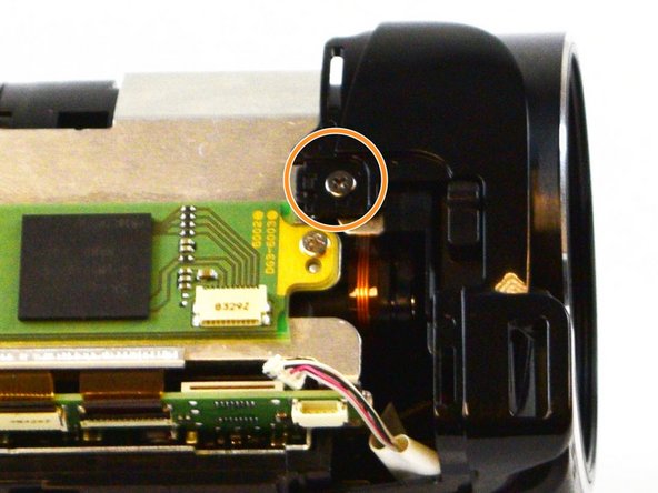

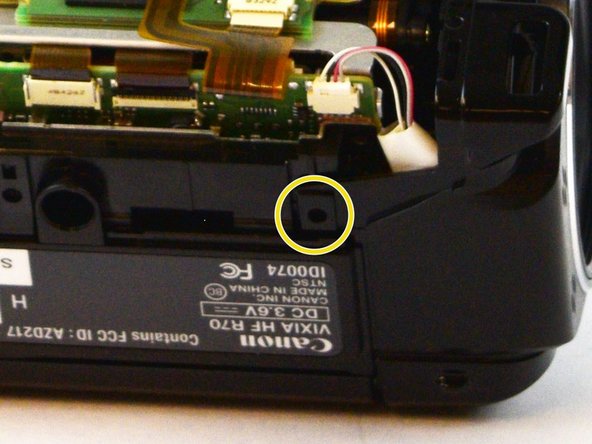

  17. Canon Vixia HF R70 Lens Replacement, Shutter: crwdns2935265:017crwdnd2935265:01crwdnd2935265:03crwdne2935265:0 Canon Vixia HF R70 Lens Replacement, Shutter: crwdns2935265:017crwdnd2935265:02crwdnd2935265:03crwdne2935265:0 Canon Vixia HF R70 Lens Replacement, Shutter: crwdns2935265:017crwdnd2935265:03crwdnd2935265:03crwdne2935265:0
    • There are three 5mm Phillips #00 screws that need to be removed - one on the top, one on the side, and one on the bottom.
    • Locate and remove the screw on the top side of the camera.
    • Locate and remove the screw on the side of the camera where you previously removed the side panel.
    • Locate and remove the screw on the bottom of the camera.

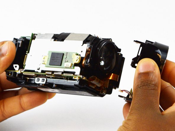

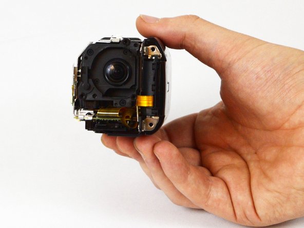

    • Pull the entire shutter away from the body of the camera to remove it.
  19. Canon Vixia HF R70 Lens Replacement, Lens: crwdns2935265:019crwdnd2935265:01crwdnd2935265:02crwdne2935265:0 Canon Vixia HF R70 Lens Replacement, Lens: crwdns2935265:019crwdnd2935265:02crwdnd2935265:02crwdne2935265:0

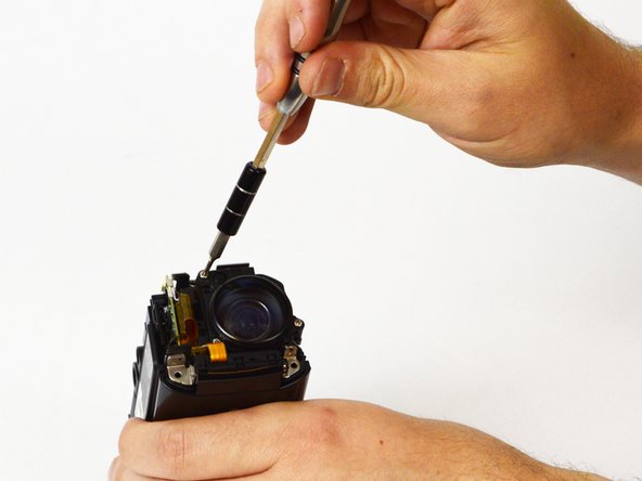

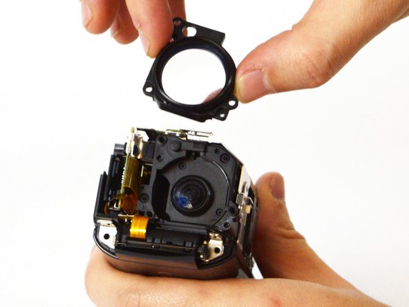

    • With the front of the camera facing you, locate and remove the three 5mm Phillips #00 screws that hold the lens in place.
  20. Canon Vixia HF R70 Lens Replacement: crwdns2935265:020crwdnd2935265:01crwdnd2935265:03crwdne2935265:0 Canon Vixia HF R70 Lens Replacement: crwdns2935265:020crwdnd2935265:02crwdnd2935265:03crwdne2935265:0 Canon Vixia HF R70 Lens Replacement: crwdns2935265:020crwdnd2935265:03crwdnd2935265:03crwdne2935265:0
    • Grasp the plastic sides of the lens, and pull it away from the camera body to finish removing the lens.
