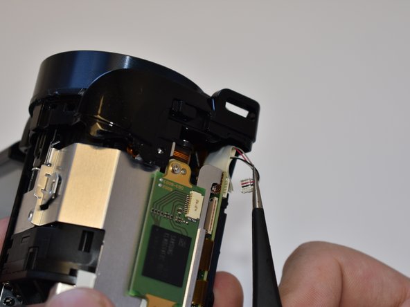

  7. Canon Vixia HF R62 Display Panel Replacement: crwdns2935265:07crwdnd2935265:01crwdnd2935265:03crwdne2935265:0 Canon Vixia HF R62 Display Panel Replacement: crwdns2935265:07crwdnd2935265:02crwdnd2935265:03crwdne2935265:0 Canon Vixia HF R62 Display Panel Replacement: crwdns2935265:07crwdnd2935265:03crwdnd2935265:03crwdne2935265:0

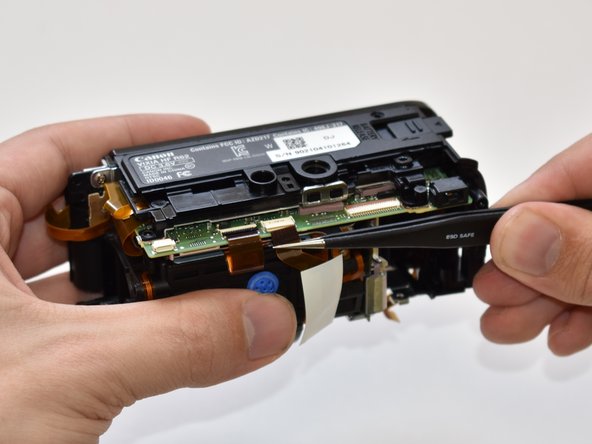

    • Using tweezers, disconnect this ribbon cable by pulling straight out.
  8. Canon Vixia HF R62 Display Panel Replacement: crwdns2935265:08crwdnd2935265:01crwdnd2935265:03crwdne2935265:0 Canon Vixia HF R62 Display Panel Replacement: crwdns2935265:08crwdnd2935265:02crwdnd2935265:03crwdne2935265:0 Canon Vixia HF R62 Display Panel Replacement: crwdns2935265:08crwdnd2935265:03crwdnd2935265:03crwdne2935265:0
    • Repeat step seven (7) for the remaining three wires shown.

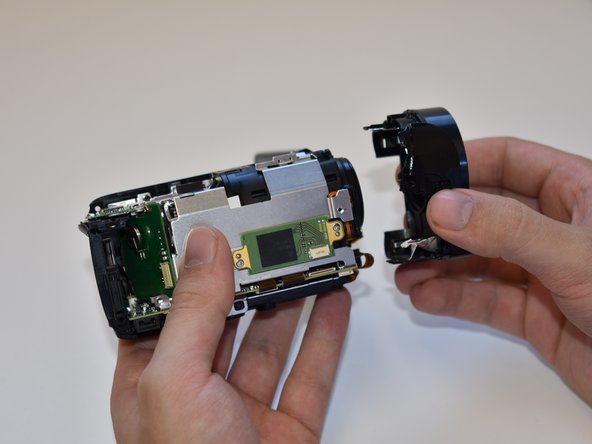

  13. Canon Vixia HF R62 Display Panel Replacement: crwdns2935265:013crwdnd2935265:01crwdnd2935265:02crwdne2935265:0 Canon Vixia HF R62 Display Panel Replacement: crwdns2935265:013crwdnd2935265:02crwdnd2935265:02crwdne2935265:0
    • Remove the lens cover by pulling straight away from the body.

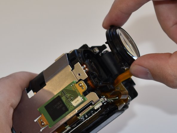

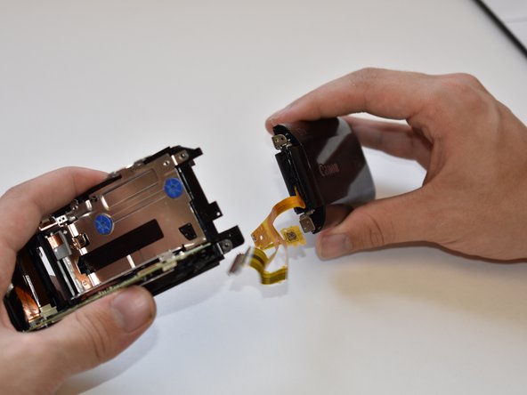

  15. Canon Vixia HF R62 Display Panel Replacement: crwdns2935265:015crwdnd2935265:01crwdnd2935265:02crwdne2935265:0 Canon Vixia HF R62 Display Panel Replacement: crwdns2935265:015crwdnd2935265:02crwdnd2935265:02crwdne2935265:0
    • Remove the lens by pulling straight away from the main body.
    • Be aware of the small rubber gasket around the lens as it may come loose.

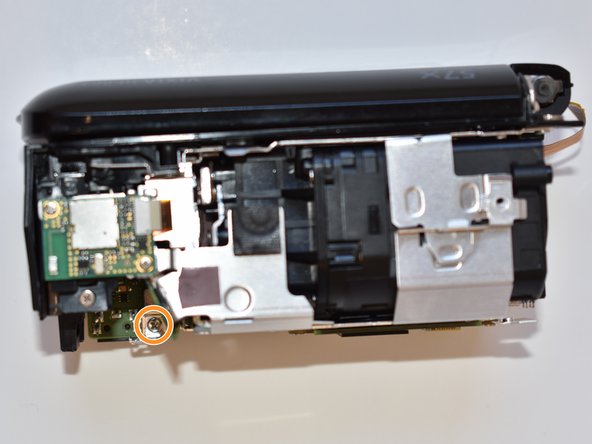

  18. Canon Vixia HF R62 Display Panel Replacement: crwdns2935265:018crwdnd2935265:01crwdnd2935265:01crwdne2935265:0
    • Remove the 4mm Phillips #000 screw at the bottom of the camera.

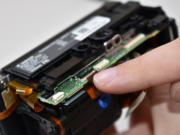

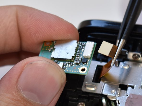

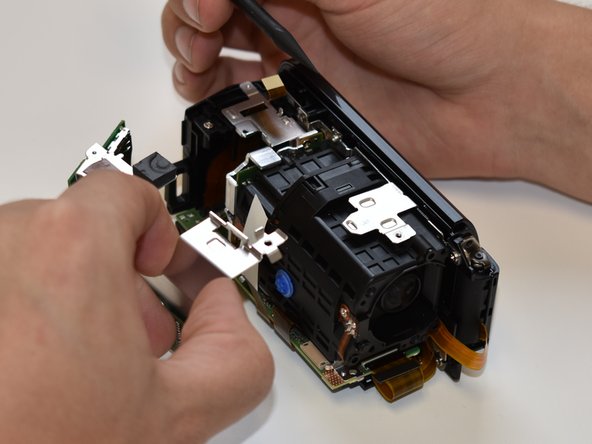

  19. Canon Vixia HF R62 Display Panel Replacement: crwdns2935265:019crwdnd2935265:01crwdnd2935265:03crwdne2935265:0 Canon Vixia HF R62 Display Panel Replacement: crwdns2935265:019crwdnd2935265:02crwdnd2935265:03crwdne2935265:0 Canon Vixia HF R62 Display Panel Replacement: crwdns2935265:019crwdnd2935265:03crwdnd2935265:03crwdne2935265:0
    • Place the spudger under the tab shown.
    • While prying the tab up with the spudger, pull the case away.

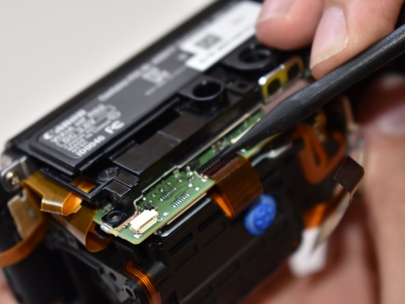

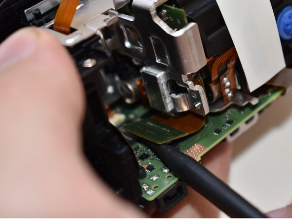

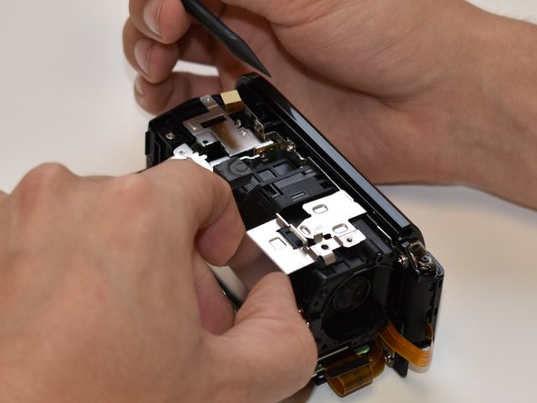

  20. Canon Vixia HF R62 Display Panel Replacement, Central Capturing Unit: crwdns2935265:020crwdnd2935265:01crwdnd2935265:03crwdne2935265:0 Canon Vixia HF R62 Display Panel Replacement, Central Capturing Unit: crwdns2935265:020crwdnd2935265:02crwdnd2935265:03crwdne2935265:0 Canon Vixia HF R62 Display Panel Replacement, Central Capturing Unit: crwdns2935265:020crwdnd2935265:03crwdnd2935265:03crwdne2935265:0
    • Using a spudger, disconnect the ribbon cable connector from the PC board shown in the picture.

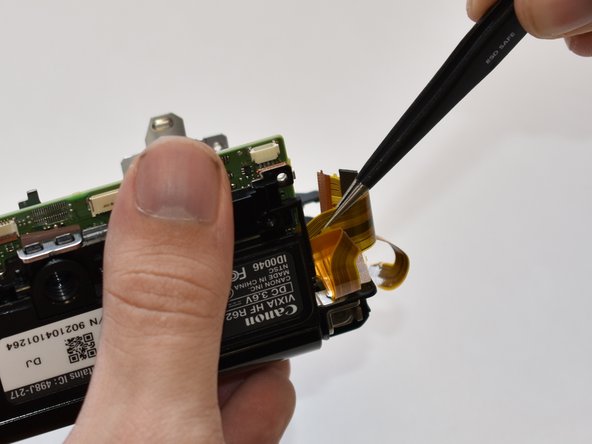

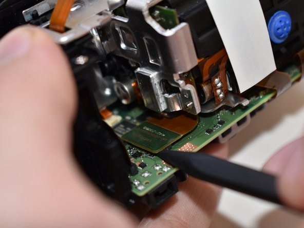

  21. Canon Vixia HF R62 Display Panel Replacement: crwdns2935265:021crwdnd2935265:01crwdnd2935265:02crwdne2935265:0 Canon Vixia HF R62 Display Panel Replacement: crwdns2935265:021crwdnd2935265:02crwdnd2935265:02crwdne2935265:0
    • Using tweezers, disconnect the ribbon cable shown in the picture by pulling straight out.

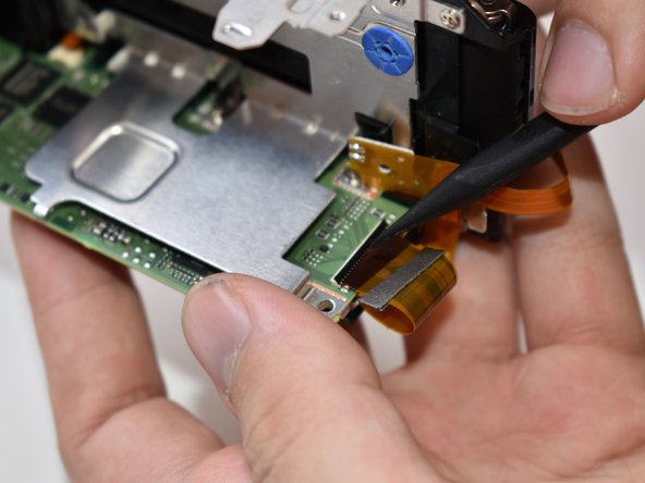

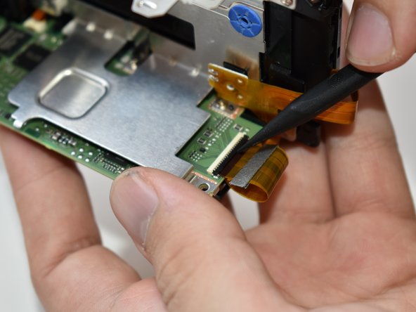

  22. Canon Vixia HF R62 Display Panel Replacement: crwdns2935265:022crwdnd2935265:01crwdnd2935265:03crwdne2935265:0 Canon Vixia HF R62 Display Panel Replacement: crwdns2935265:022crwdnd2935265:02crwdnd2935265:03crwdne2935265:0 Canon Vixia HF R62 Display Panel Replacement: crwdns2935265:022crwdnd2935265:03crwdnd2935265:03crwdne2935265:0
    • Using a spudger, gently pry up the top tab on the ZIF connector. The wire will now disconnect with no force needed.
    • When reassembling you will need to place the ribbon wire tightly against the tab in order to properly secure it.

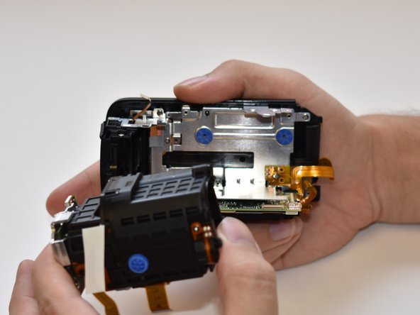

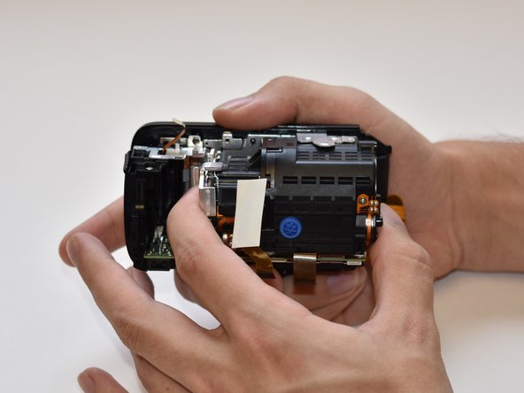

  23. Canon Vixia HF R62 Display Panel Replacement: crwdns2935265:023crwdnd2935265:01crwdnd2935265:03crwdne2935265:0 Canon Vixia HF R62 Display Panel Replacement: crwdns2935265:023crwdnd2935265:02crwdnd2935265:03crwdne2935265:0 Canon Vixia HF R62 Display Panel Replacement: crwdns2935265:023crwdnd2935265:03crwdnd2935265:03crwdne2935265:0
    • Using your fingers, firmly grasp both ends of the capturing device and gently pull the assembly straight out.

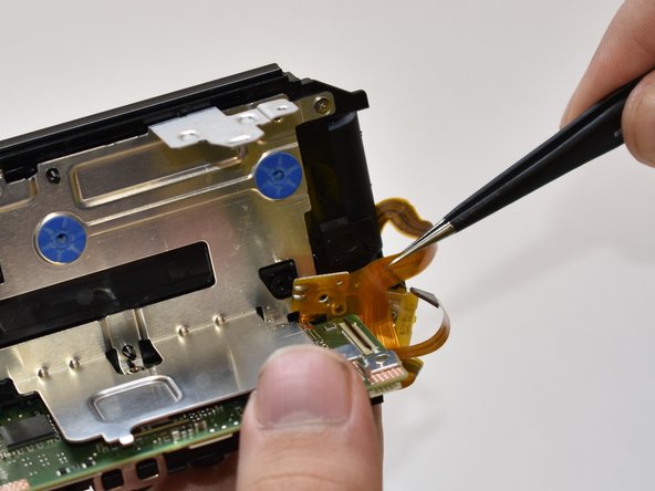

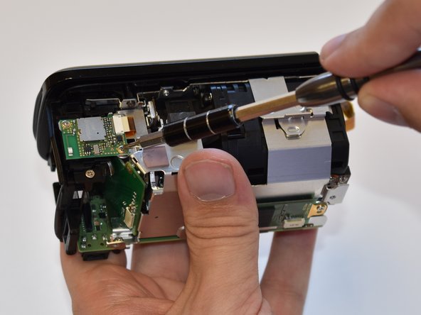

  25. Canon Vixia HF R62 Display Panel Replacement: crwdns2935265:025crwdnd2935265:01crwdnd2935265:03crwdne2935265:0 Canon Vixia HF R62 Display Panel Replacement: crwdns2935265:025crwdnd2935265:02crwdnd2935265:03crwdne2935265:0 Canon Vixia HF R62 Display Panel Replacement: crwdns2935265:025crwdnd2935265:03crwdnd2935265:03crwdne2935265:0
    • Undo the ZIF connector from the motherboard using a plastic spudger. Use the spudger to pry the small tab on top of the ZIF connector and the ribbon cable will fall free.
    • When reassembling, you will need to place the ribbon cable tightly against the tab in order to properly secure it.

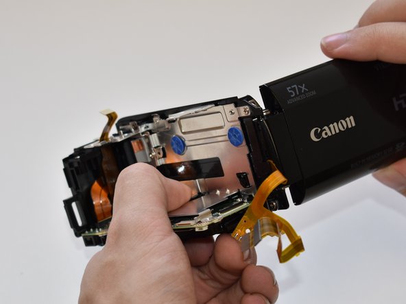

  27. Canon Vixia HF R62 Display Panel Replacement: crwdns2935265:027crwdnd2935265:01crwdnd2935265:03crwdne2935265:0 Canon Vixia HF R62 Display Panel Replacement: crwdns2935265:027crwdnd2935265:02crwdnd2935265:03crwdne2935265:0 Canon Vixia HF R62 Display Panel Replacement: crwdns2935265:027crwdnd2935265:03crwdnd2935265:03crwdne2935265:0
    • The ribbon cable is also looped around a piece of the casing under the motherboard. Unfasten this cable with tweezers by sliding down and then pulling out.

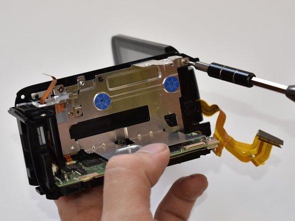

  28. Canon Vixia HF R62 Display Panel Replacement: crwdns2935265:028crwdnd2935265:01crwdnd2935265:02crwdne2935265:0 Canon Vixia HF R62 Display Panel Replacement: crwdns2935265:028crwdnd2935265:02crwdnd2935265:02crwdne2935265:0
    • Open the display panel.
    • This will help during the reassembly as one of the hinges locks in place and is difficult to reassemble if in the closed position.

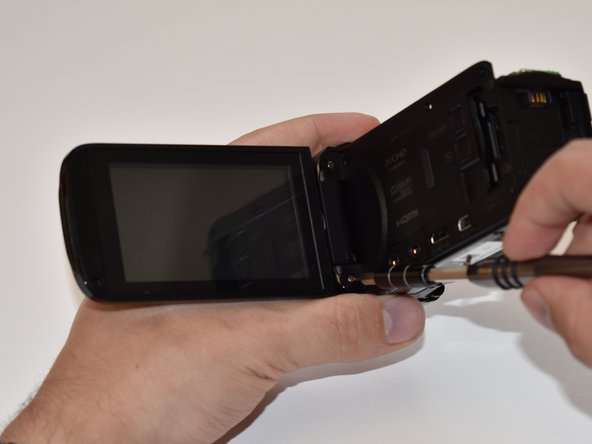

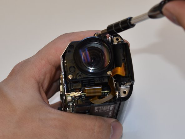

  29. Canon Vixia HF R62 Display Panel Replacement: crwdns2935265:029crwdnd2935265:01crwdnd2935265:02crwdne2935265:0 Canon Vixia HF R62 Display Panel Replacement: crwdns2935265:029crwdnd2935265:02crwdnd2935265:02crwdne2935265:0
    • Remove the two 3mm Phillips #000 screws connecting to the display panel's hinges.
