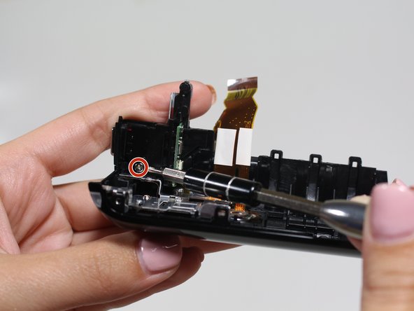

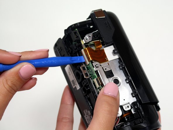

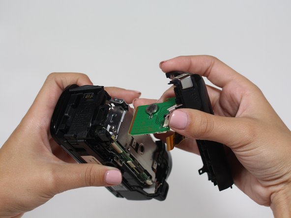

  7. Canon Vixia HF R600 Power Button Replacement, Speaker: crwdns2935265:07crwdnd2935265:01crwdnd2935265:02crwdne2935265:0 Canon Vixia HF R600 Power Button Replacement, Speaker: crwdns2935265:07crwdnd2935265:02crwdnd2935265:02crwdne2935265:0
    • Remove one 4mm Phillips JIS#00 screw on the right side of the camera.
    • Use the plastic opening tool to undo the bronze ribbon connector.
  8. Canon Vixia HF R600 Power Button Replacement: crwdns2935265:08crwdnd2935265:01crwdnd2935265:02crwdne2935265:0 Canon Vixia HF R600 Power Button Replacement: crwdns2935265:08crwdnd2935265:02crwdnd2935265:02crwdne2935265:0
    • Remove one 4mm Phillips JIS#00 screw located on the top of the camera near the battery connection.
    • Pull the plastic casing away from the camera. The speaker and power button are housed in this casing.

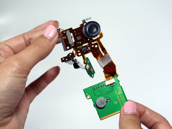

  9. Canon Vixia HF R600 Power Button Replacement: crwdns2935265:09crwdnd2935265:01crwdnd2935265:02crwdne2935265:0 Canon Vixia HF R600 Power Button Replacement: crwdns2935265:09crwdnd2935265:02crwdnd2935265:02crwdne2935265:0
    • Remove four 5mm Phillips PH#00 screws holding the speaker bracket in place.
    • Remove one more 5mm screw below the power button.
  10. Canon Vixia HF R600 Power Button Replacement: crwdns2935265:010crwdnd2935265:01crwdnd2935265:02crwdne2935265:0 Canon Vixia HF R600 Power Button Replacement: crwdns2935265:010crwdnd2935265:02crwdnd2935265:02crwdne2935265:0
    • Carefully pull the speaker out of the casing.

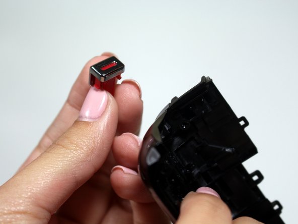

  11. Canon Vixia HF R600 Power Button Replacement, Power Button: crwdns2935265:011crwdnd2935265:01crwdnd2935265:02crwdne2935265:0 Canon Vixia HF R600 Power Button Replacement, Power Button: crwdns2935265:011crwdnd2935265:02crwdnd2935265:02crwdne2935265:0
    • Using a pair of tweezers, gently push in the red tabs of the power button.
    • Pull the power button out of the camera casing.
