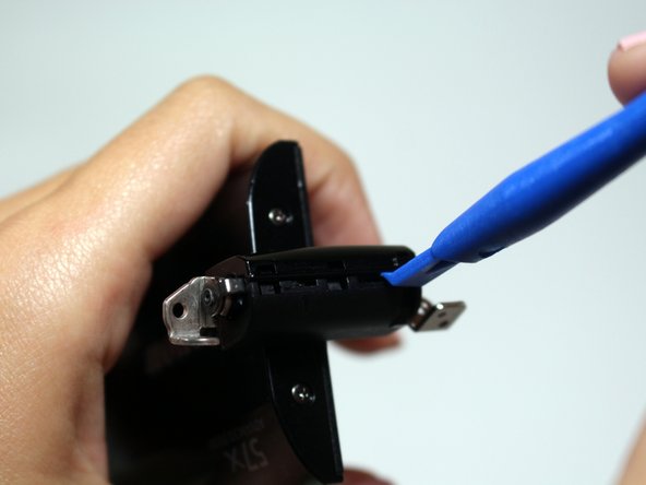

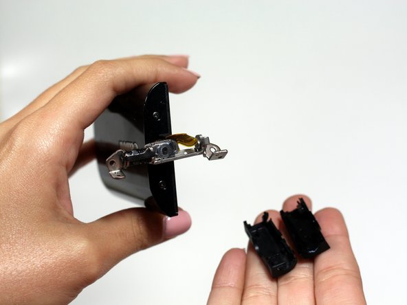

  8. Canon Vixia HF R600 LCD screen Replacement: crwdns2935265:08crwdnd2935265:01crwdnd2935265:03crwdne2935265:0 Canon Vixia HF R600 LCD screen Replacement: crwdns2935265:08crwdnd2935265:02crwdnd2935265:03crwdne2935265:0 Canon Vixia HF R600 LCD screen Replacement: crwdns2935265:08crwdnd2935265:03crwdnd2935265:03crwdne2935265:0
    • Rotate the display hinge to reveal two 4mm Phillips #00 screws.
    • Before removing, use the plastic opening tool to pry apart the plastic hinge cover.
    • Remove the cover.

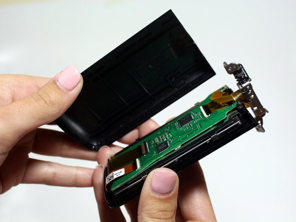

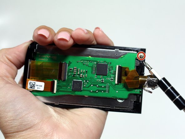

  9. Canon Vixia HF R600 LCD screen Replacement: crwdns2935265:09crwdnd2935265:01crwdnd2935265:03crwdne2935265:0 Canon Vixia HF R600 LCD screen Replacement: crwdns2935265:09crwdnd2935265:02crwdnd2935265:03crwdne2935265:0 Canon Vixia HF R600 LCD screen Replacement: crwdns2935265:09crwdnd2935265:03crwdnd2935265:03crwdne2935265:0
    • Remove the two 4mm Phillips #00 screws.
    • Pull the LCD display back cover to reveal the motherboard covering the screen.
    • Remove one more 4mm Phillips #00 screw.

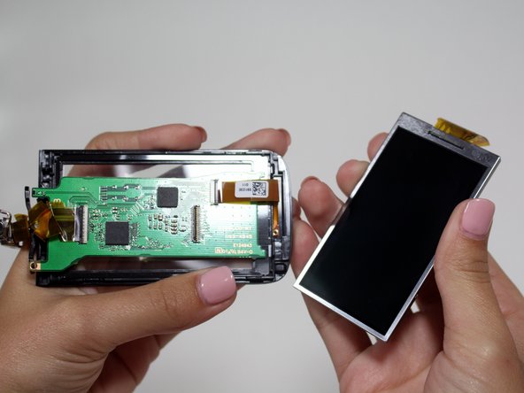

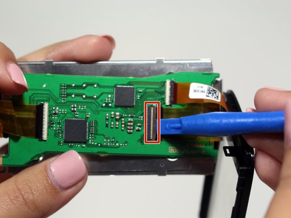

  10. Canon Vixia HF R600 LCD screen Replacement: crwdns2935265:010crwdnd2935265:01crwdnd2935265:03crwdne2935265:0 Canon Vixia HF R600 LCD screen Replacement: crwdns2935265:010crwdnd2935265:02crwdnd2935265:03crwdne2935265:0 Canon Vixia HF R600 LCD screen Replacement: crwdns2935265:010crwdnd2935265:03crwdnd2935265:03crwdne2935265:0
    • Pull the screen protector away from the LCD display.
    • Use a plastic opening tool to lift the ribbon connector tab.
    • The LCD display can now be replaced!
