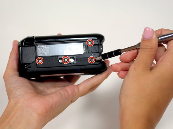

  4. Canon Vixia HF R600 Casing Replacement, Casing: crwdns2935265:04crwdnd2935265:01crwdnd2935265:02crwdne2935265:0 Canon Vixia HF R600 Casing Replacement, Casing: crwdns2935265:04crwdnd2935265:02crwdnd2935265:02crwdne2935265:0
    • Start by removing the two 6mm Phillips #00 screws located on the right side of the camera.
    • Remove four more 6mm Phillips #00 screws found on the bottom of the camera.

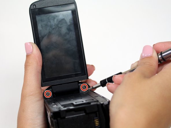

  5. Canon Vixia HF R600 Casing Replacement: crwdns2935265:05crwdnd2935265:01crwdnd2935265:02crwdne2935265:0 Canon Vixia HF R600 Casing Replacement: crwdns2935265:05crwdnd2935265:02crwdnd2935265:02crwdne2935265:0
    • Open the display screen and remove the three 5mm Phillips #00 screws.
    • Look to the swivel point for the screen to find the last two 5mm Phillips #00 screws that must be removed.

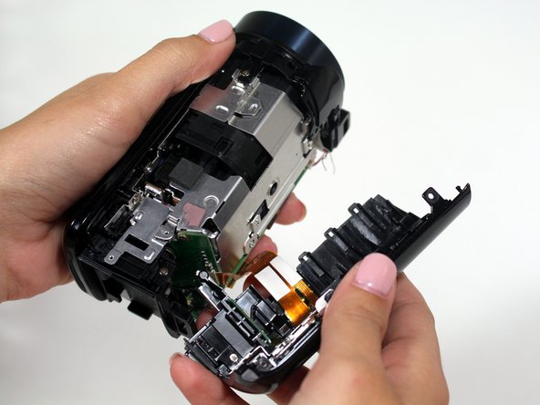

  6. Canon Vixia HF R600 Casing Replacement: crwdns2935265:06crwdnd2935265:01crwdnd2935265:02crwdne2935265:0 Canon Vixia HF R600 Casing Replacement: crwdns2935265:06crwdnd2935265:02crwdnd2935265:02crwdne2935265:0
    • Gently pull the plastic casing away from the camera.
