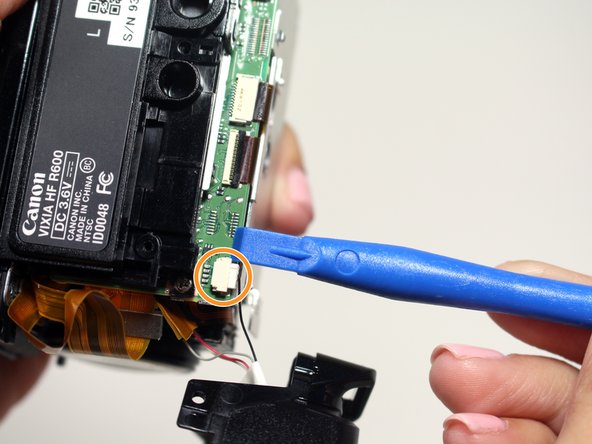

  7. Canon Vixia HF R600 Camera Lens Replacement, Camera Lens: crwdns2935265:07crwdnd2935265:01crwdnd2935265:03crwdne2935265:0 Canon Vixia HF R600 Camera Lens Replacement, Camera Lens: crwdns2935265:07crwdnd2935265:02crwdnd2935265:03crwdne2935265:0 Canon Vixia HF R600 Camera Lens Replacement, Camera Lens: crwdns2935265:07crwdnd2935265:03crwdnd2935265:03crwdne2935265:0
    • Remove one 5mm Phillips PH#00 screw from the top of the camera.
    • Pull away the plastic shutter casing; this contains the microphone.
    • Using the plastic opening tool or something similar, carefully disconnect the white 4 pin connector to remove the shutter casing.

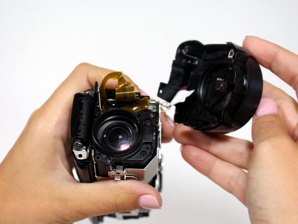

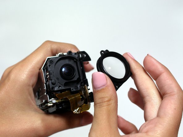

  8. Canon Vixia HF R600 Camera Lens Replacement: crwdns2935265:08crwdnd2935265:01crwdnd2935265:02crwdne2935265:0 Canon Vixia HF R600 Camera Lens Replacement: crwdns2935265:08crwdnd2935265:02crwdnd2935265:02crwdne2935265:0
    • Remove the three 5mm Phillips PH#00 screws surrounding the camera lens.
    • Pull the lens off of the camera and replace.
