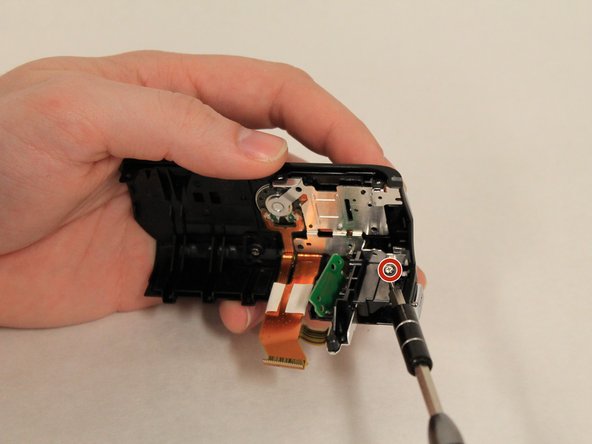

  15. Canon Vixia HF R500 Zoom Control  Replacement: crwdns2935265:015crwdnd2935265:01crwdnd2935265:02crwdne2935265:0 Canon Vixia HF R500 Zoom Control  Replacement: crwdns2935265:015crwdnd2935265:02crwdnd2935265:02crwdne2935265:0
    • Holding the full top piece remove the six 5mm Philips #000 screws holding the metal frame to the top piece.
  16. Canon Vixia HF R500 Zoom Control  Replacement: crwdns2935265:016crwdnd2935265:01crwdnd2935265:01crwdne2935265:0
    • Carefully remove the the whole metal frame out of the device piece.
  17. Canon Vixia HF R500 Zoom Control  Replacement: crwdns2935265:017crwdnd2935265:01crwdnd2935265:01crwdne2935265:0
    • Replace the defective speaker with a functioning one.

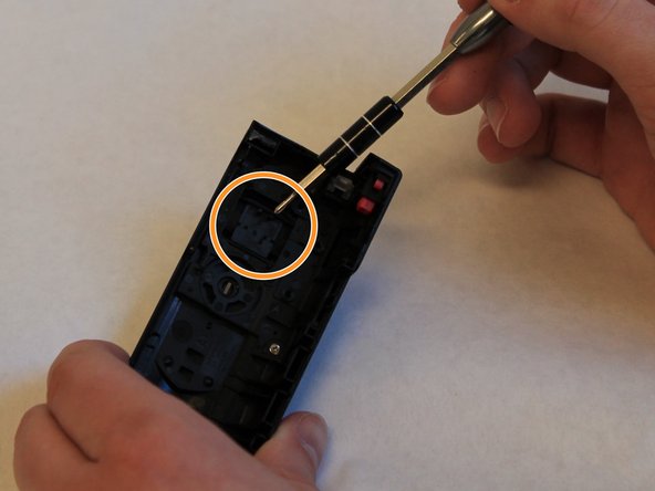

  18. Canon Vixia HF R500 Zoom Control  Replacement, Zoom Control: crwdns2935265:018crwdnd2935265:01crwdnd2935265:02crwdne2935265:0 Canon Vixia HF R500 Zoom Control  Replacement, Zoom Control: crwdns2935265:018crwdnd2935265:02crwdnd2935265:02crwdne2935265:0
    • Examine the grey zoom input tab located on copper plate.
    • Examine the black plastic zoom slider, on the top cover of the camera
    • Repair or replace damaged components and clear all debris from mechanisms.
