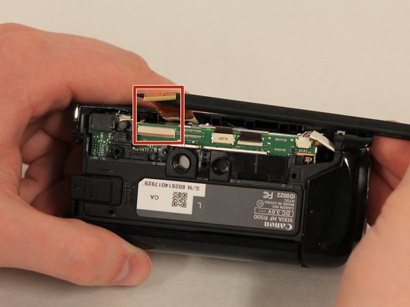

  6. Canon Vixia HF R500 Disassembly: crwdns2935265:06crwdnd2935265:01crwdnd2935265:01crwdne2935265:0
    • Using the spudger, pull the tab shown to start removing the ribbon cable.

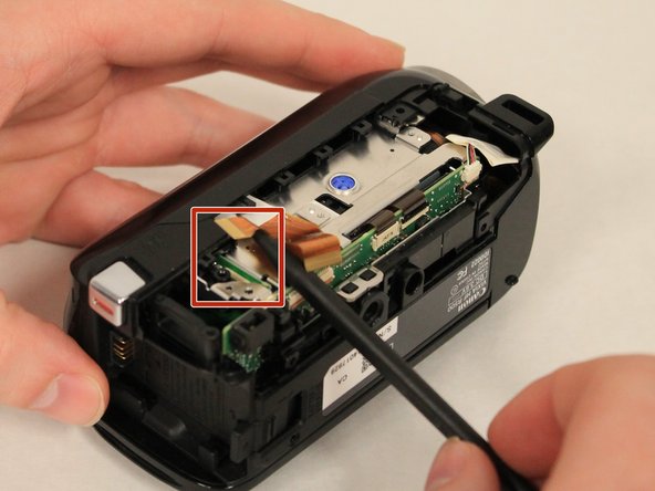

  7. Canon Vixia HF R500 Disassembly: crwdns2935265:07crwdnd2935265:01crwdnd2935265:03crwdne2935265:0 Canon Vixia HF R500 Disassembly: crwdns2935265:07crwdnd2935265:02crwdnd2935265:03crwdne2935265:0 Canon Vixia HF R500 Disassembly: crwdns2935265:07crwdnd2935265:03crwdnd2935265:03crwdne2935265:0
    • Using the Spudger, carefully remove the two ribbon cables that are connected to the top of the device.
